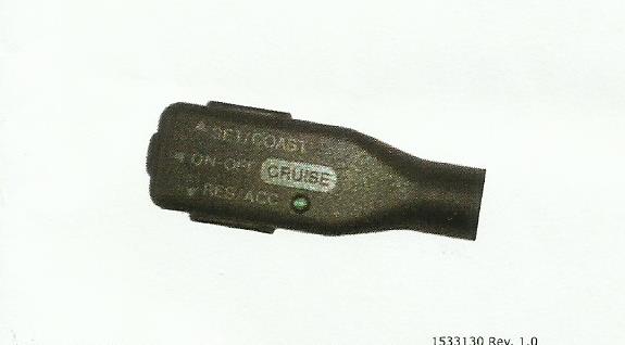

I temporarily abandoned the idea but later went to a competent local auto electrician who supplied and fitted a cruise control module with a steering column stalk control (image attached hopefully). They made a very neat job of it and it functions perfectly. Just so as you are aware of what you are contemplating it set me back £550. A lot for something that is used relatively infrequently.Cruise Control Stalk
That aftermarket option looks a great idea :+1: the stalk pictured looks good and a lot of cars have a stalk rather than steering wheel controls. Just for info, the actual OEM steering wheels are the same under the skin. Blanking plates can be swapped out for switches but as said, where do you go from there if no wiring in place after the switch.
