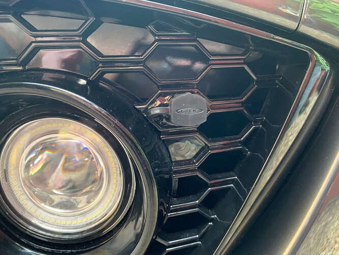

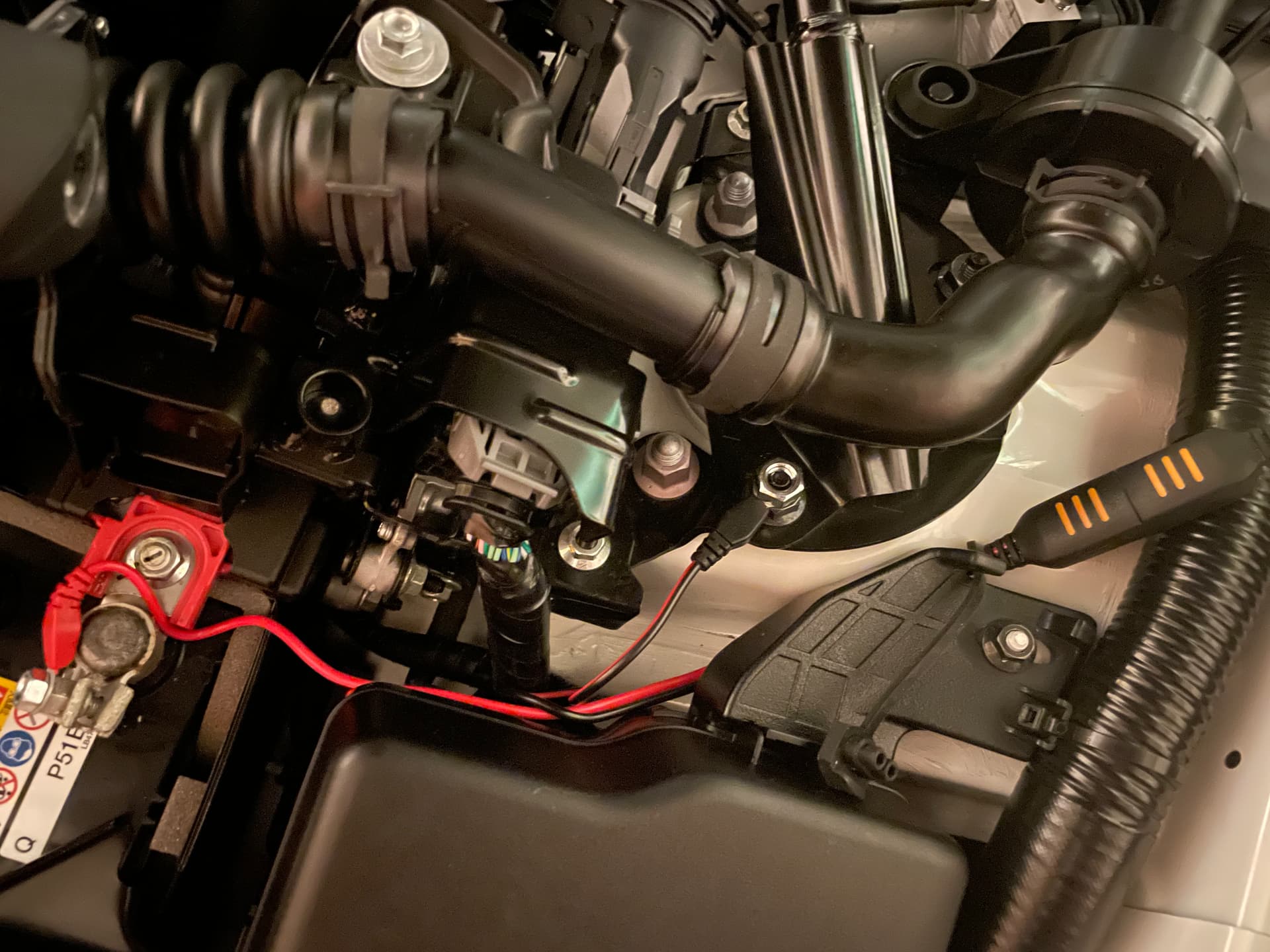

I have CTEK but I have wired mine through the front grill couple of pics for Reference
On our RF I have used the kit to connect directly to the battery. Allows fairly easy connection/disconnection. Not quite as professional as having the connector built into the front grill.

Exactly how I did it.The connecting cable comes out of the front under the bonnet and is placed so it is not crushed when bonnet is closed
