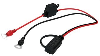

I have connected a short fused Ctek connector to my battery so it simply plugs in.
