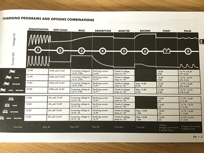

Once it’s in maintenance phase, both NORMAL and AGM seem to be 13.6v according to manual.
@Countryboy I guess they’re not smart enough to know what battery they’re connected to and each battery type has a different program see pic … :+1:

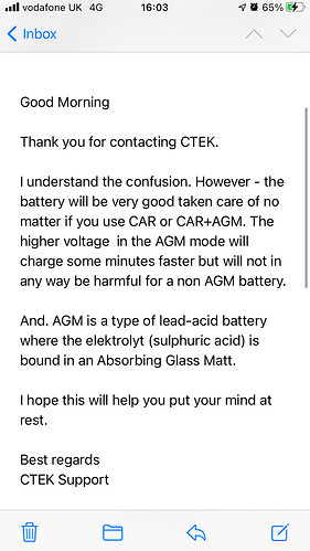

@JBCCDU Very odd, here’s the email response i had from them… I guess in a nutshell is shouldn’t matter what of the two car modes you use it in :man_shrugging:t2:
@Dawasdave yep, got a slightly different response saying that I need to check with my manufacturer for the best charging voltage and ….
“If no particular information is possible to acquire, you always can use normal charging option, 14.4V
It suits perfectly well most lead/acid batteries, including GEL, VRLA, etc., including batteries for start/stop vehicles like EFB and AGM”
At that point I moved on :joy: and just used NORMAL mode as suggested,it works fine , and if I want to leave it on long term, I’m happier doing that on the slightly lower voltage.
In all truth it’s probably no issue either way :wink:
