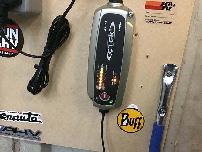

I therefore set my Ctek MXS 5.0 with just the Car yellow LED lit. (I kept pressing the red Mode button until it looked like this). It remembers that setting for next time I plug it in :slightly_smiling_face:
