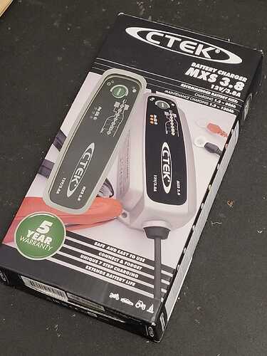

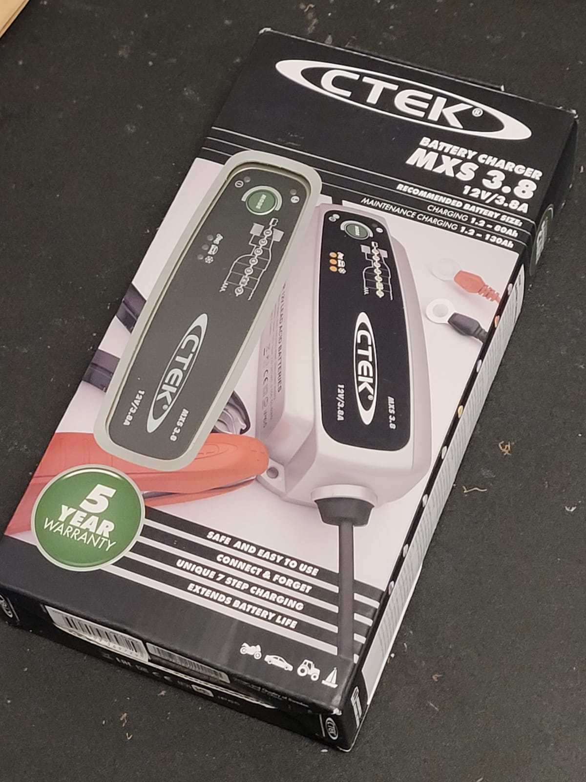

Well my CTEK charger finally arrived today. So I’ll hook it up over the weekend to fully charge my ND3 battery directly on the battery posts and we’ll see if it causes
any confusion and unwanted warnings or malfunctions. Maybe that will help answer your question?
Yes, good one. If poss, charge it when the car is all working fine, no warnings, everything working like showroom. Hopefully, when the ctek hits green for fully charged and you unplug it, all will be the same as it was- working fine with no having to drive around for 90 days or disconnecting everything including the seats and wheels lol
(P.S I don’t use both battery ports, I use the positive red one, and a nearby nut for the black one)
Yes, will do. I’ll connect on the clamp nuts so effectively by-passing the current sensor correct? Yes, right now my ND3 2024 is running perfectly with all previous i-Stop and Battery malfunction warnings completely cleared by itself, as of today. The battery might not be fully 90-100% charged compared to showroom, I’m guessing it’s close to 80% SOC. I’ll monitor the charging to see how long it stays in the ‘BULK’ charging stage, I’m assuming not too long and it should enter the ‘FLOAT’ stage after the final 20% charge pretty quickly. We’ll see. I’ll then switch ignition on, check for any errors, start and drive. Fingers crossed! :crossed_fingers:
(P.S. I’ll post pics to show it charging and the dash all clear after ignition hopefully)
