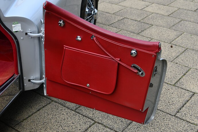

I have no advice but I love your idea; perhaps something like this XK120 door!
That looks delightful.
I’m not sure whether I have the skill to recreate something so elegant but it’s inspirational nevertheless. Thanks for sharing the idea.
By coincidence I’m also considering switching from black to a red.
Cheers,
Guy
