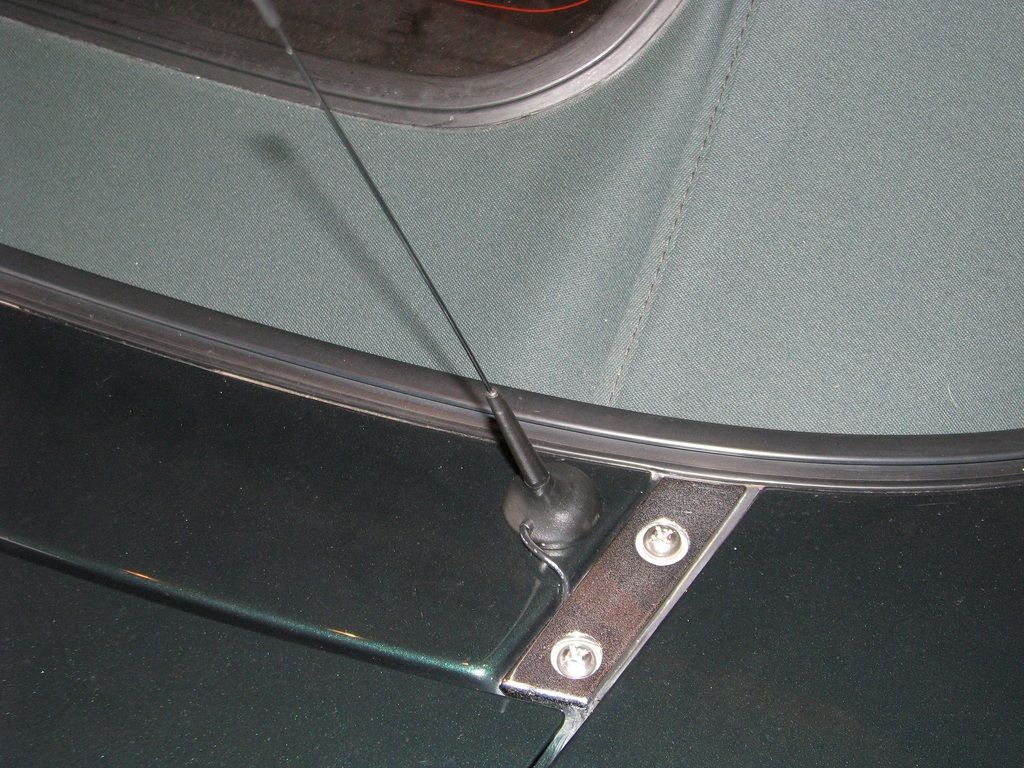

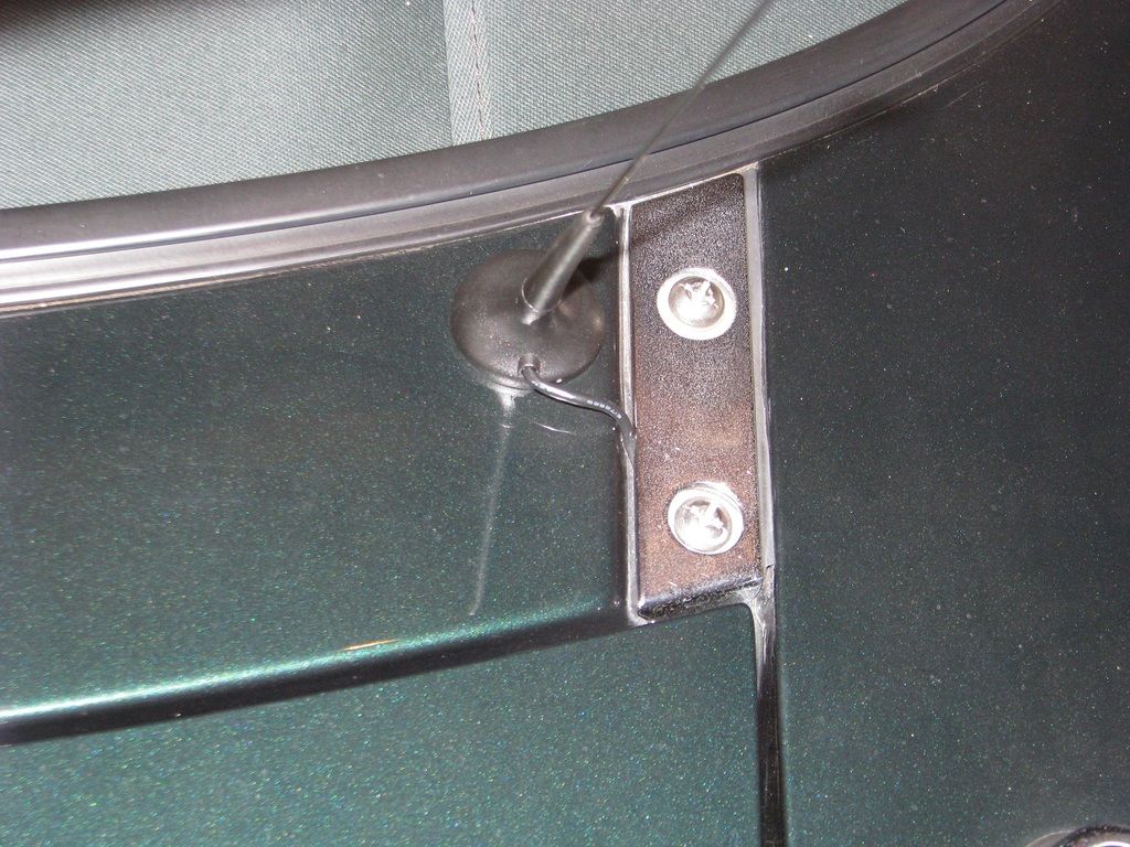

After taking advice from two car audio specialist shops, and the internet, I went for a conventional externally mounted antenna for the best and most consistent DAB reception.  I thought long and hard about the antenna positioning, and ended up with this.
The lead feeds through a tiny hole in the boot rubber seal, then on through the boot and below the centre console.  Looks neat and unobtrusive, IMHO.
Hope this helps.  Steve
