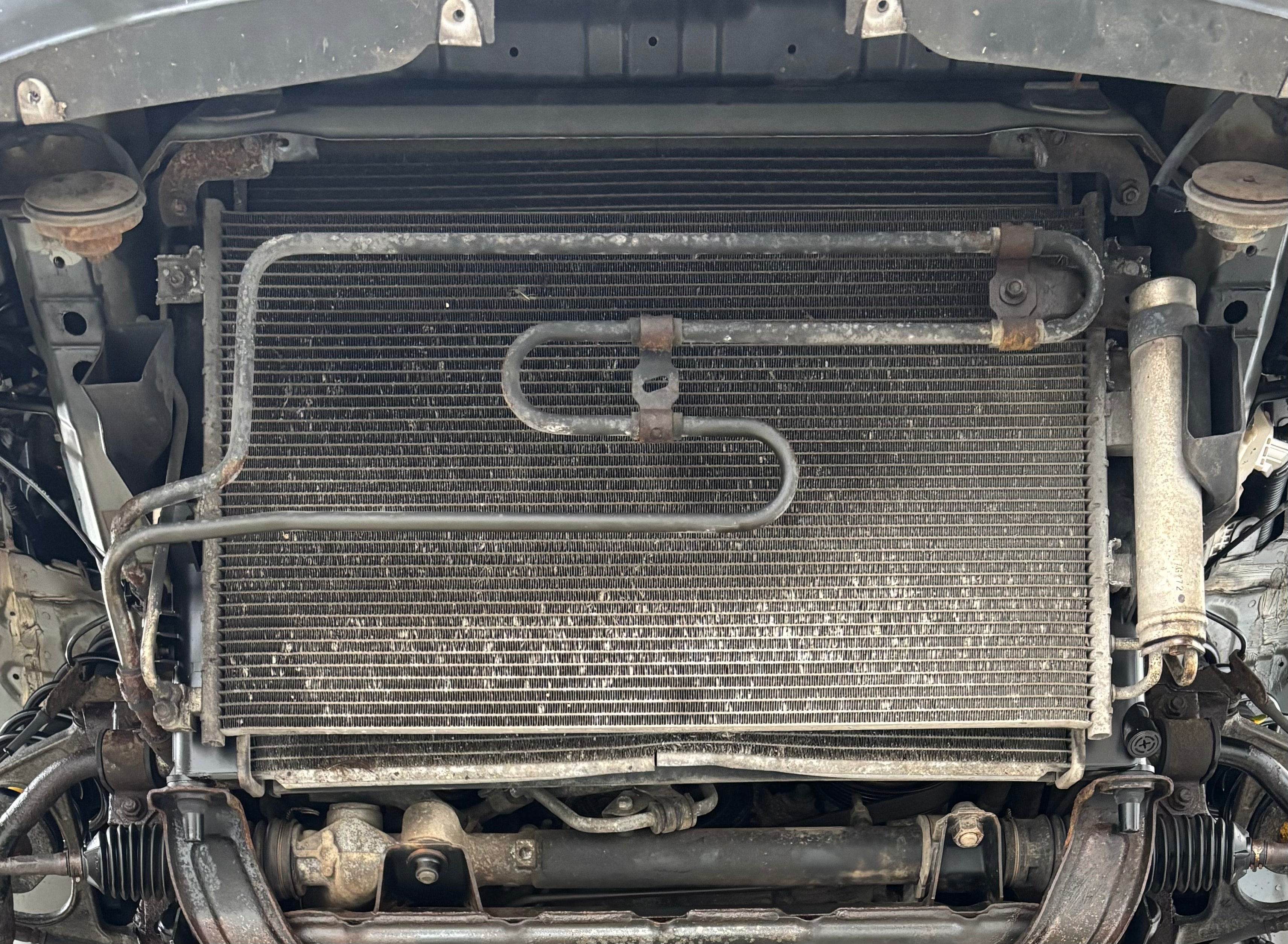

Need to replace our radiator on our 08 2.0i NC and have found 3 options, from MX-5 parts 1. Genuine £210 (cross flow single pass) 2. IL motorsports Aluminium (triple pass) £280 or via eBay Mishimoto Aluminium (cross-flow dual pass) £430 (only one with lifetime warranty) any preference or previous experience of the 2 aftermarket ones? We have air-con so also don’t know if the deeper aluminium ones will fit? Also is this A DIY job or would our local garage be a safer bet especially if the AC condenser needs to be removed to replace the rad. Any advice would be appreciated

In my opinion you are pretty much stuck with a garage as you have aircon and that will need to be drained down properly and regassed afterwards etc etc.
Also due to the nature/location of the units a ramp would make the job so much easier.

Thanks for the info, we intend to keep the car for many years ( as long as it’s lasts or we get too old to get in and out of it​:grinning_face_with_smiling_eyes: so don’t mind investing in something that we last. Being so close to the condenser was my concern it would have to be taken out to fit the rad so as you say that rules me out. Regards
A quick search suggests you “maybe” able to get the radiator out without disconnecting the condenser lines etc.
