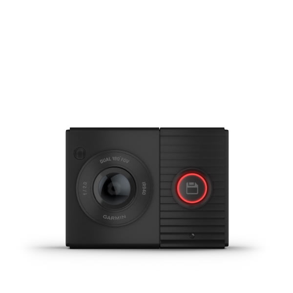

You could consider a different model from Garmin which I have mounted in my ND2:
Our MX-5 cabins are relatively small and the interior camera almost behaves like a rear view camera :+1:
As you are probably already aware, you’ll need to purchase Garmin’s parking mode cable if you were to opt for one of their dash cams. I have their mini suction cup mount which I’m hesitant to recommend since I’ve had it fall off on me a few times, only when parked up for long durations.
A potential issue with this dash cam is when your car has its MOT test. You may have to temporarily relocate the dash cam to in front of the rear view mirror to avoid a potential fail for windscreen obstruction. This is why I opted for the suction cup mount instead of the included mount.
