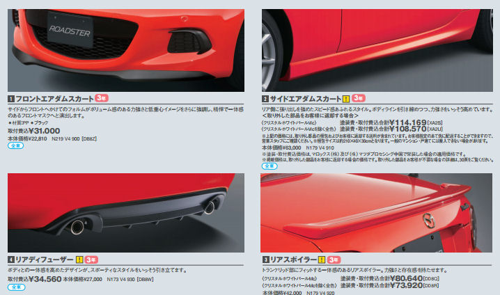

Side skirts next?
They don’t do any suitable add ons that match. I’ve seen that some people use mk1 add ons but they’re not a perfect fit.
You don’t like the Mazda ones?
The mazda speed ones?
No the NC2/3 optional skirt would be good.
The Mazdaspeed skirts only suits if you have the full bodykit.
I’d love to see them if you know what the part number is
These are the only ones I’ve seen.
Part number was N179V4910, may be different in UK
Thanks. It looks like those are entire skirts then someone has added the extension. I’d prefer not to have to paint anything, and though I’d love to add extensions that match if I can’t find any I’m happy to leave it as is :+1:
