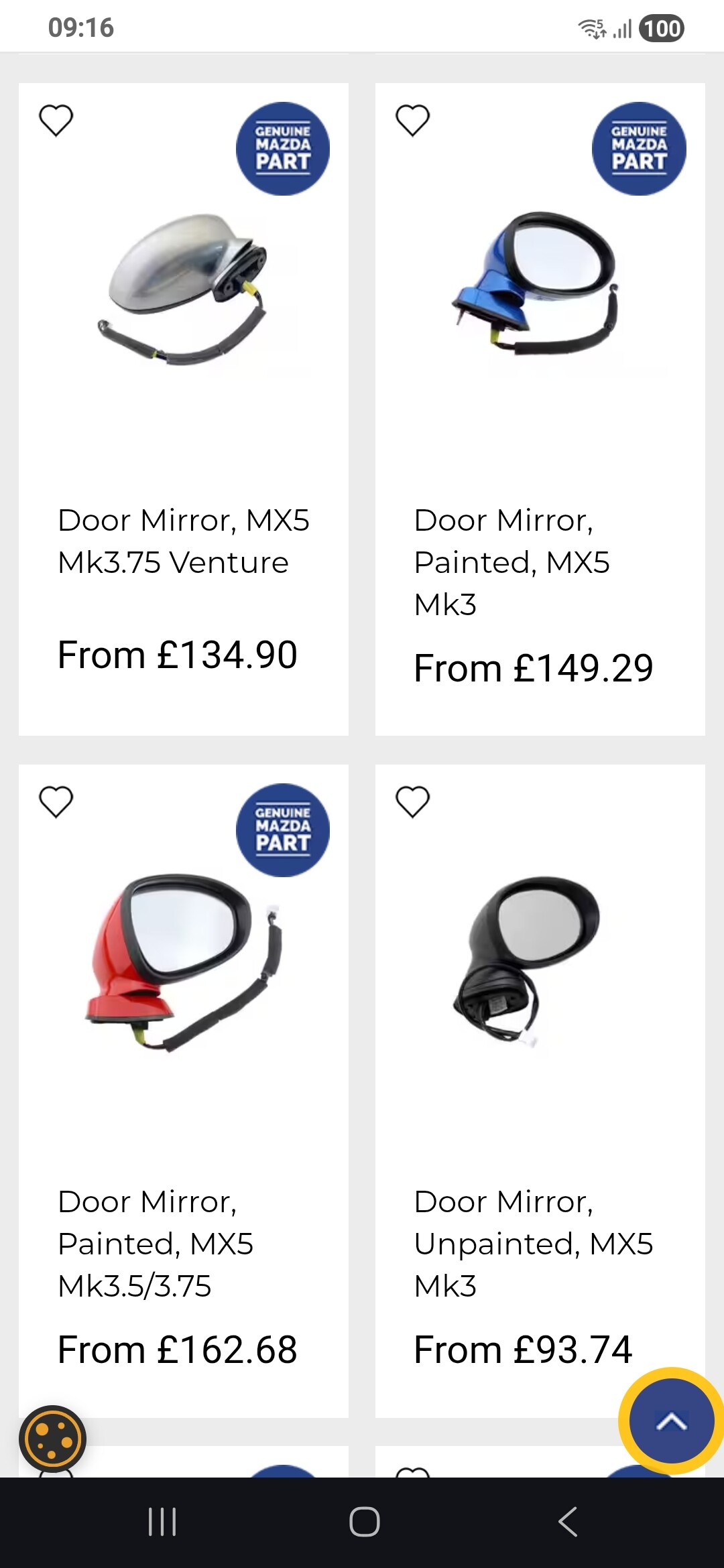

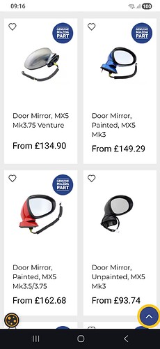

Commiserations……. I’ve knocked off 5 of my wing mirrors over the years, two on my last NC and three on Alfa 164s. It’s only a matter of time before I knock one off my ND. I had to buy new ones for the NC as could never locate a scrapper.
MX-5 Parts sell them complete, painted or unpainted. I bought one for my NC painted for about £150 ready to bolt on. I don’t think Mazda sell the parts separately. Plus you get a 10% discount when you enter your e mail address as a member of the owners club.
