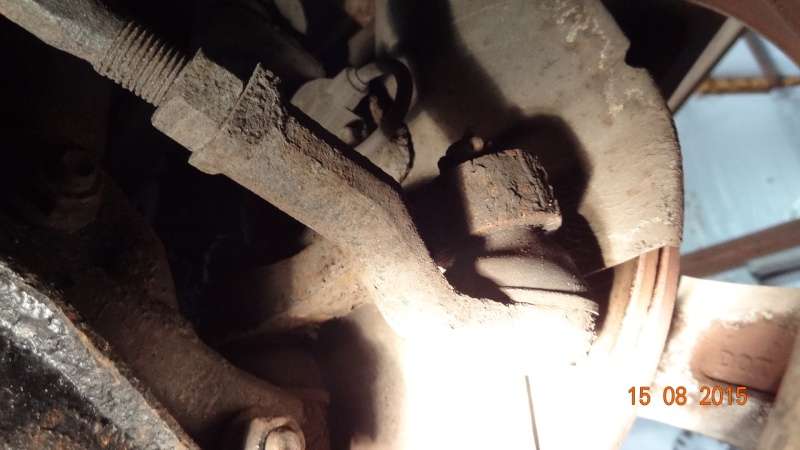

Lower front suspension ball joint and boot.

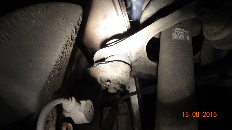

Upper front suspension and boot.
Track rod end
All the boots look a bit tired but watertight.

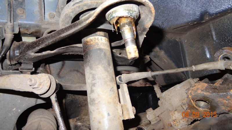

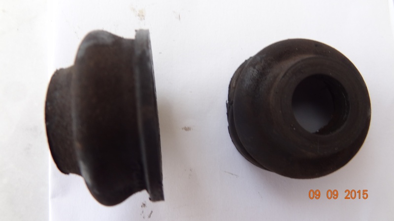

Upper boots

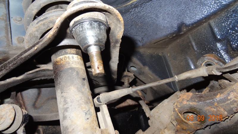

Upper ball joint minus Boot

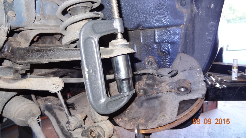

Pressing on the Upper boot, using a 12 point 30mm socket. It was very easy and not at all as difficult as some suggest.
