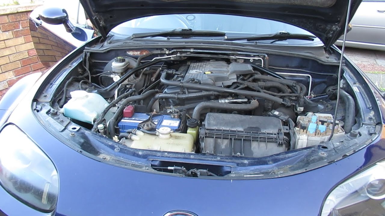

I know what I think it is, but I’m a subaru guy, we have certain low expectations. What do y’all think? I used to have a 2.2 diesel Mondeo and it basically sounded exactly like this!

First things to check would be the pulleys and tensioner for the auxiliary belt.
Were around £100 to replace the lot incl belt when I did mine.
You can whip the belt off and start up, run only for a few secs.
That deeper knocking on high revs seems to me to point to maybe a tensioner rather than in the actual engine.
Any advice is given as to check first, I’m not a mechanical wiz but we’ve been asked to diagnose similar sounds before, some have been shot pulley/tensioners.
Oh, what mileage BTW?
As mick says…
First check is serpentine belt n pulleys ![]()
Unfortunately it sounds like a small end (gudgeon pin) bearing failed to me. The noise seems to occur as the engine crests it’s revs, which is the point that the pin bearing is unloaded and where you will usually hear it.
There’s an outside chance it could be the big end although these usually make a ‘heavier’ sound.
As others have said it’s worth running the engine without the belts on the off chance it’s something less expensive.

Somebody’s robbed your fuse and battery covers unless you’ve been doing some work there ![]()
My first step was to try and remove or nail down everything else that was rattling in the car. But I stopped after those covers because I realised it’s more rattle than car. It was like trying to put out a fire by removing all the burny.

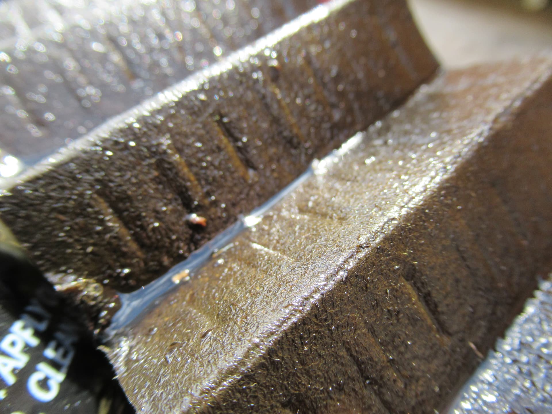

If the oil filter hasn’t been done for a while then remove it and cut it open, all the evidence will be contained within. The engine oil will also be of the funky sparkling type too.
He needs to be aware that every time it’s run and driven it’s making it worse too, right up until it lets go completely with a big bang.
Sorry for slow followup, thought I should post back inevitable sparkles:
I am kinda impressed by how it’s held together- like I mentioned I picked up the car just south of Reading, drove it to Edinburgh, then took it to a trackday all with the rattle only slightly worsening. I was really expecting the oil to be absolutely fabulous and shiny, and the filter to be packed, after all that but tbf the oil just looks like any used oil until you really get looking. Of course, it could just have easily have nipped up and destroyed itself but still. Well done broken engine.
