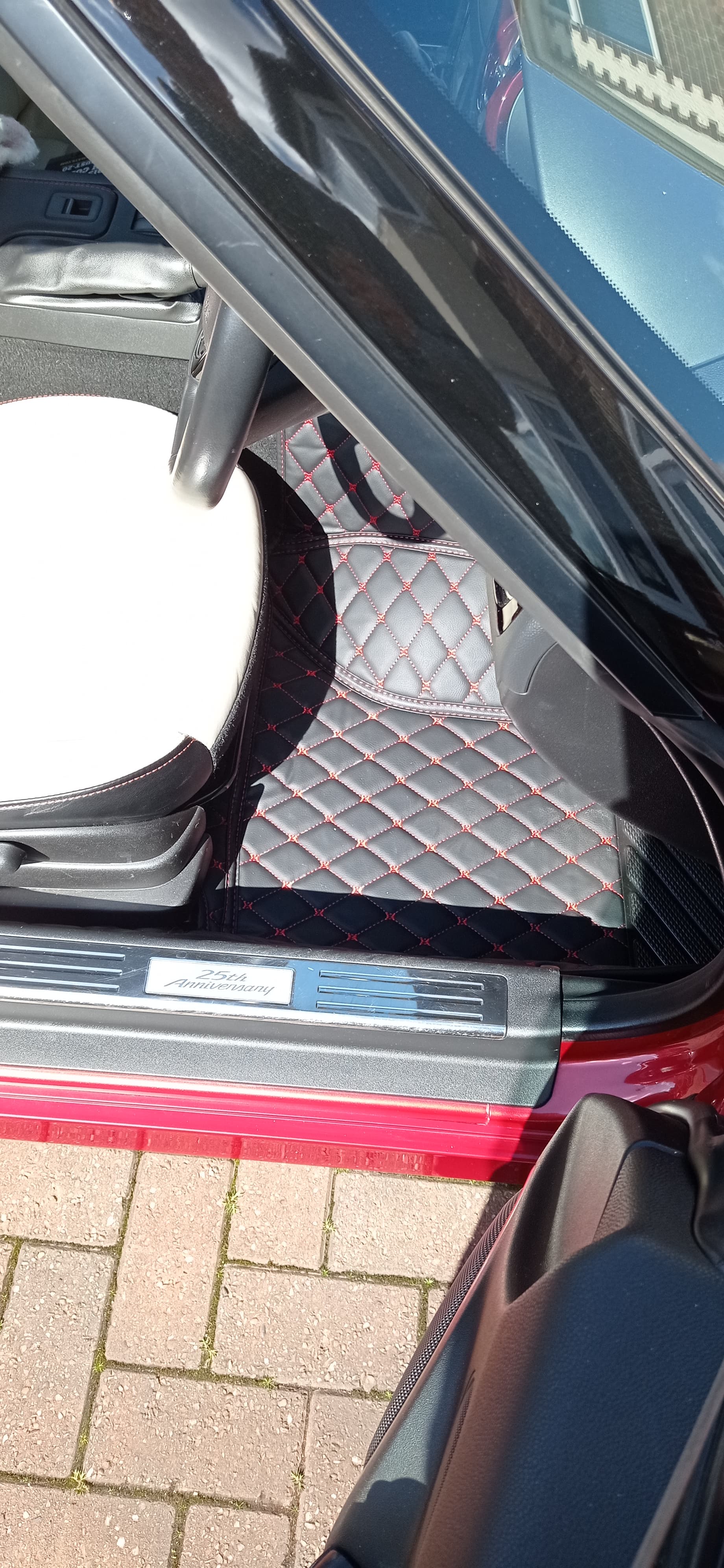

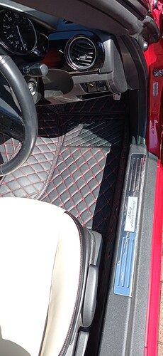

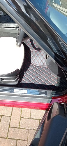

Went out this morning for a blast, put my foot down on the accelerator to get passed the vehicle in front,came to lift off the throttle but the engine stayed on full revs!!. Thinking the throttle had jammed somehow I kept prodding it with my right foot and thankfully the revs came back to normal…pulled over to check things out and on looking at the accelerator pedal,noticed there was a lip just below the pedal where the carpet finished…you would never know this could happen unless you floored the pedal to be honest. It is something I rarely do. I have now slightly moved the mat from where it should be and put strong velcro around the front edges. Hopefully this will cure the issue.

There are locating tags around the edges which I had installed correctly and the mats also have velcro tabs at various points to also hold them in place. As far as I was aware the mats were correctly installed. I now know, however,that they obviously need securing much more below the pedal area as they aren’t supplied with fasteners etc for there. I have now installed my own. This is the point of my original post.
