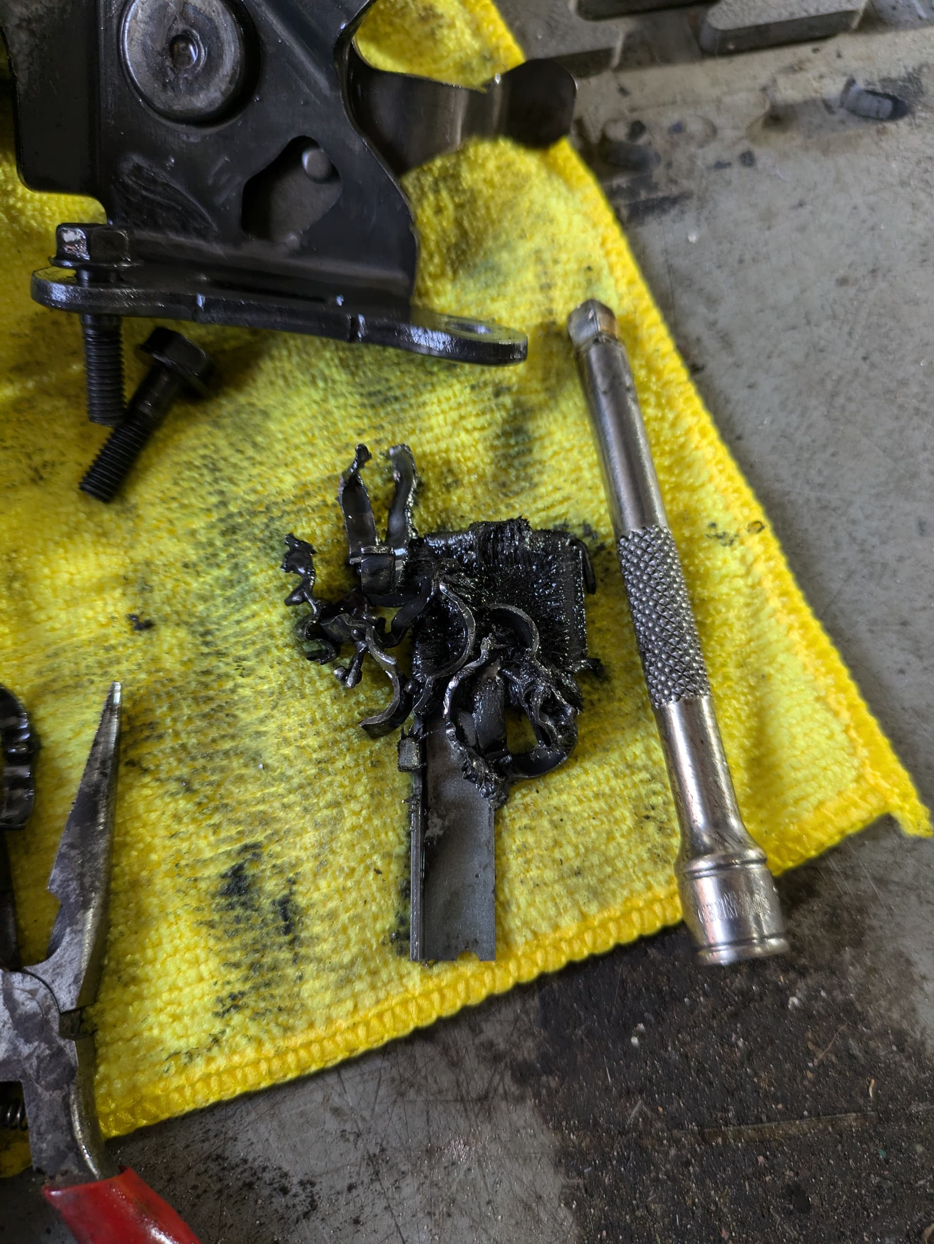

This is the magnet out of a honda gearbox I pulled apart last week, new oil and bearing, running like new. Don’t worry about a few filings.
