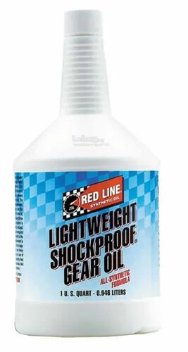

Put this in my gearbox 50/50 mix of redline mt90 and lightweight shock
