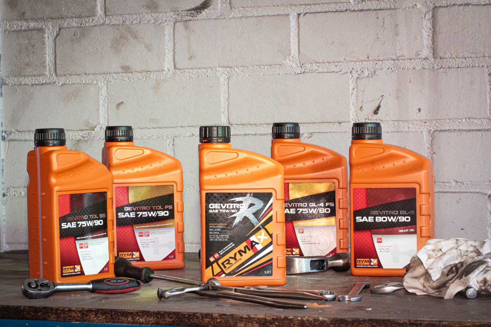

Explanation below…
That’s why I use a different oil for my gear box, to GL4 spec.
GL4/GL5 oil spec suitable for the diff whether it be an LSD or not.
As explained in that link above it’s to do with the bronze (maybe brass?) parts in the gearbox where GL5 shouldn’t be used.
