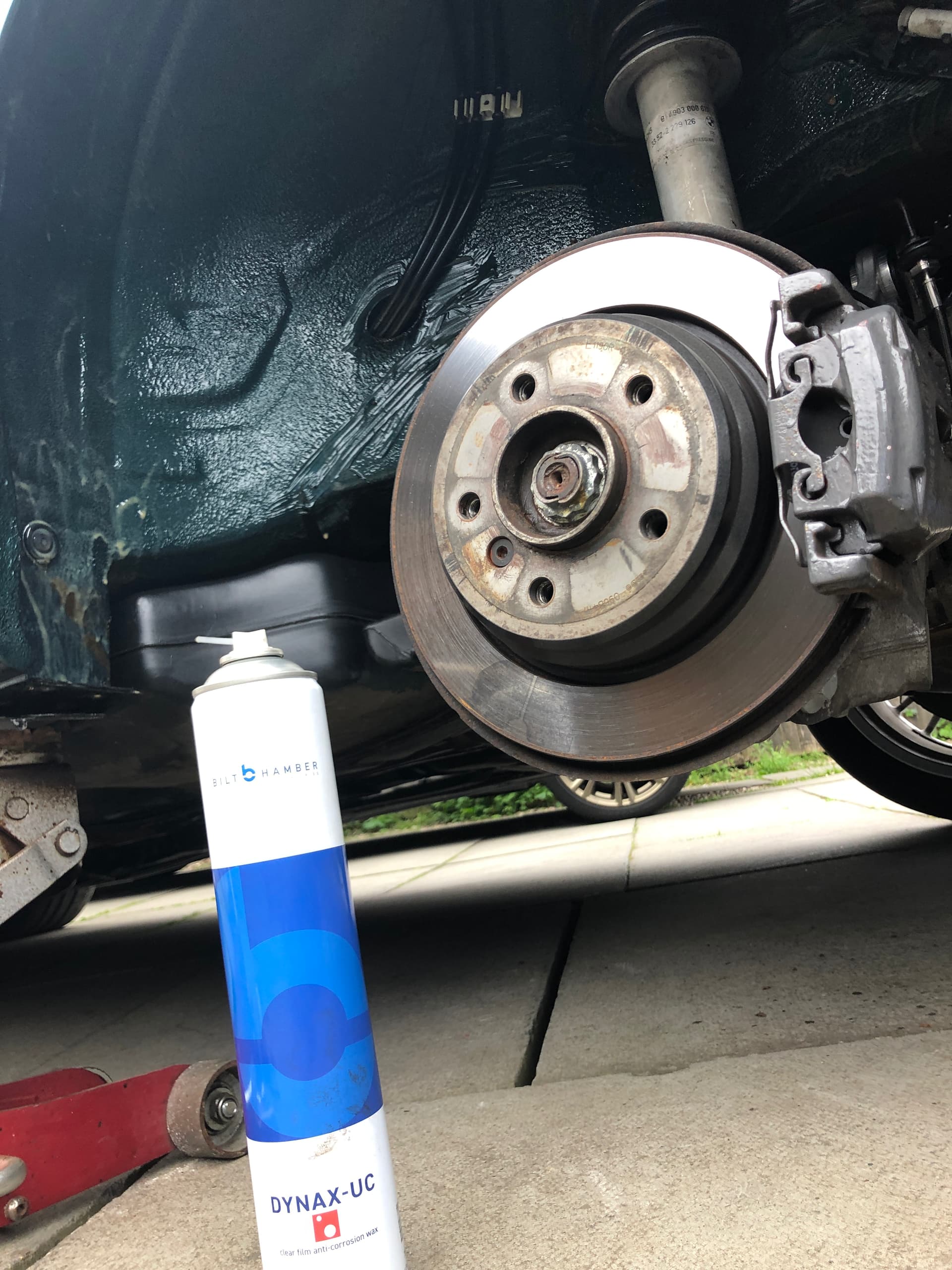

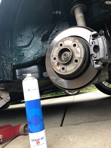

I personally would go Dinitrol ,(Bilt Hamber is also very good), from everything I have seen/read, although Lanoguard seems to do the job, it is suggested that a yearly top up is required. Around 10 years ago I did a rolling restoration on an old Porsche and I used a full kit of Dinitrol underneath on that, inside chassis legs, inner sills/outer sills etc. Messy but effective. I have since used BH on a TVR chassis and 24 year old e39 BMW touring and 27 year old Alpina. Their UB range can be had in an almost clear formula so ideal for areas you can see such as wheel arches etc, I used the darker stuff for cavities and so on. On the pic, you can see the ‘clear’ stuff just after applying.
