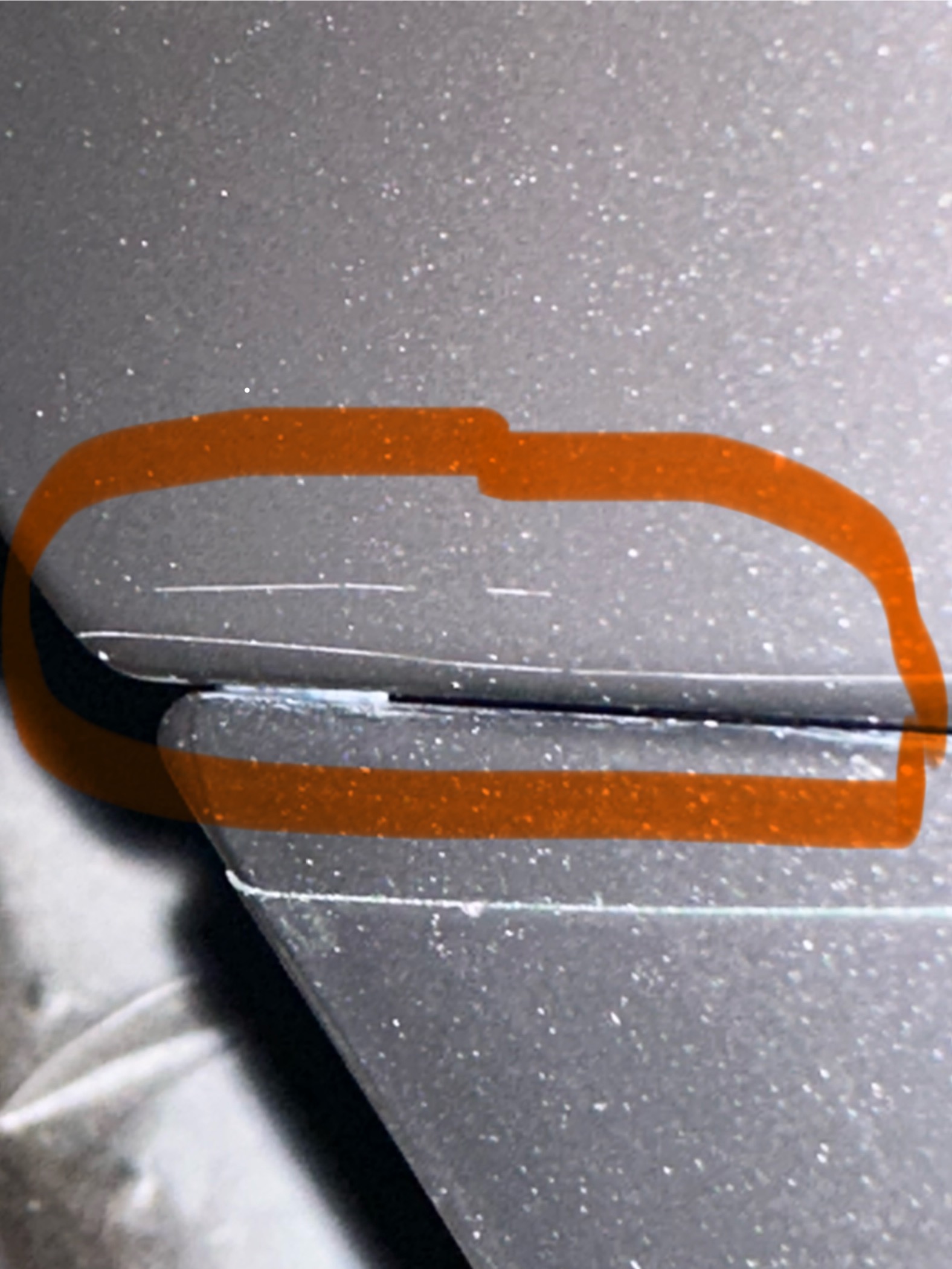

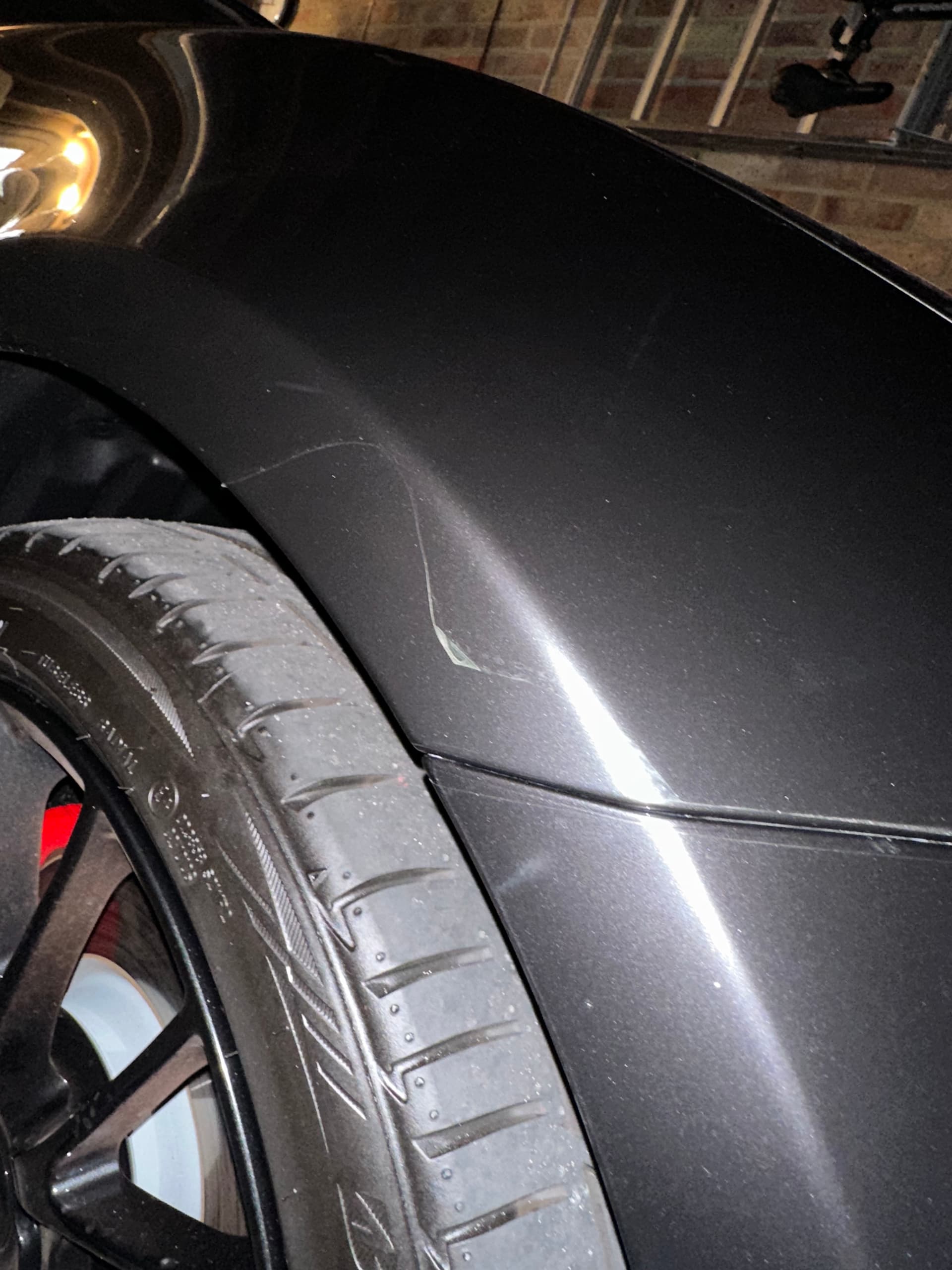

Unfortunately while peeling some back to ensure a white dot wasn’t a stone chip, I’ve just found more cut lines in the clear coat that will need wet sanding. This is on a brand new MX-5. I’m gutted to say the least.
If those scratches within the red circle are not covered by PPF, you could ask whoever is re-doing the job to polish then apply a small piece of PPF on that section.
PPF can hide scratches:
They look worse in the photo than real life and I find they disappear when wet. So I just contacted my new installer and they said they’ll be able to lightly wet sand and polish if needed before reapplying the new PPF.
