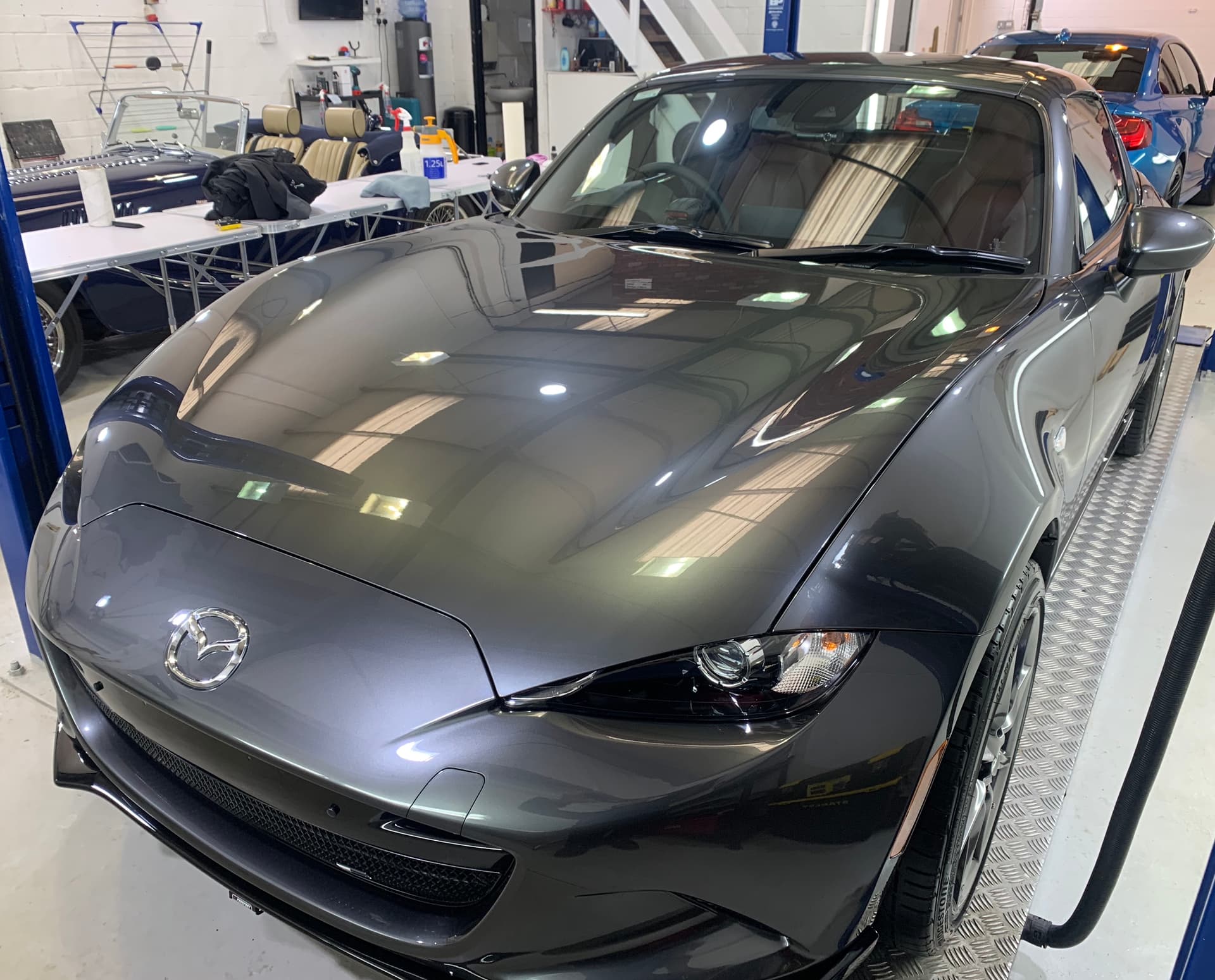

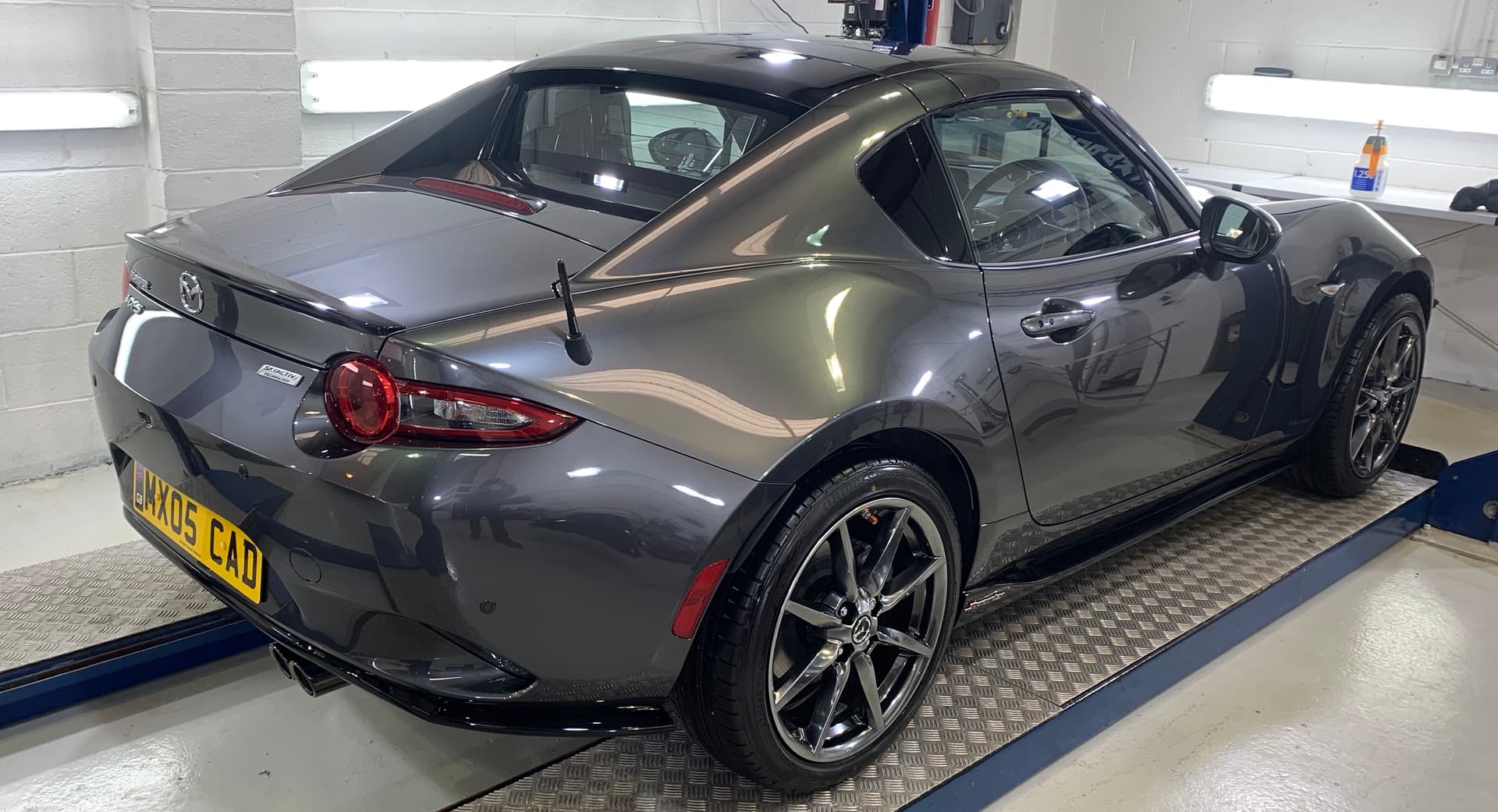

end product …
I think its all down to the installer …hope you get it sorted soon…!
