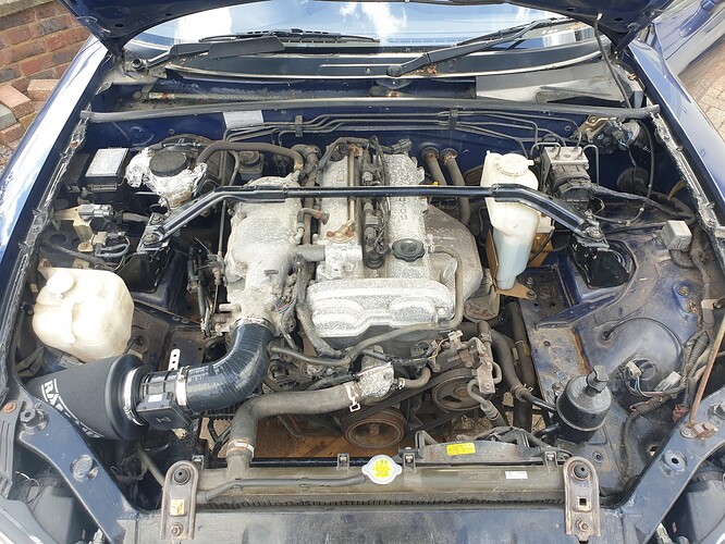

Hi all,
I have fitted a short intake and currently have the crankcase breather tubed into the new intake (see pic).
Anyone have any thoughts on this solution, and whether I need an oil catch can fitted? There seem to be mixed opionions on whether this is necessary for N/A cars, but as I have fed the tube so close to the intake manifold I’m concerned about significant amounts of oil getting in.

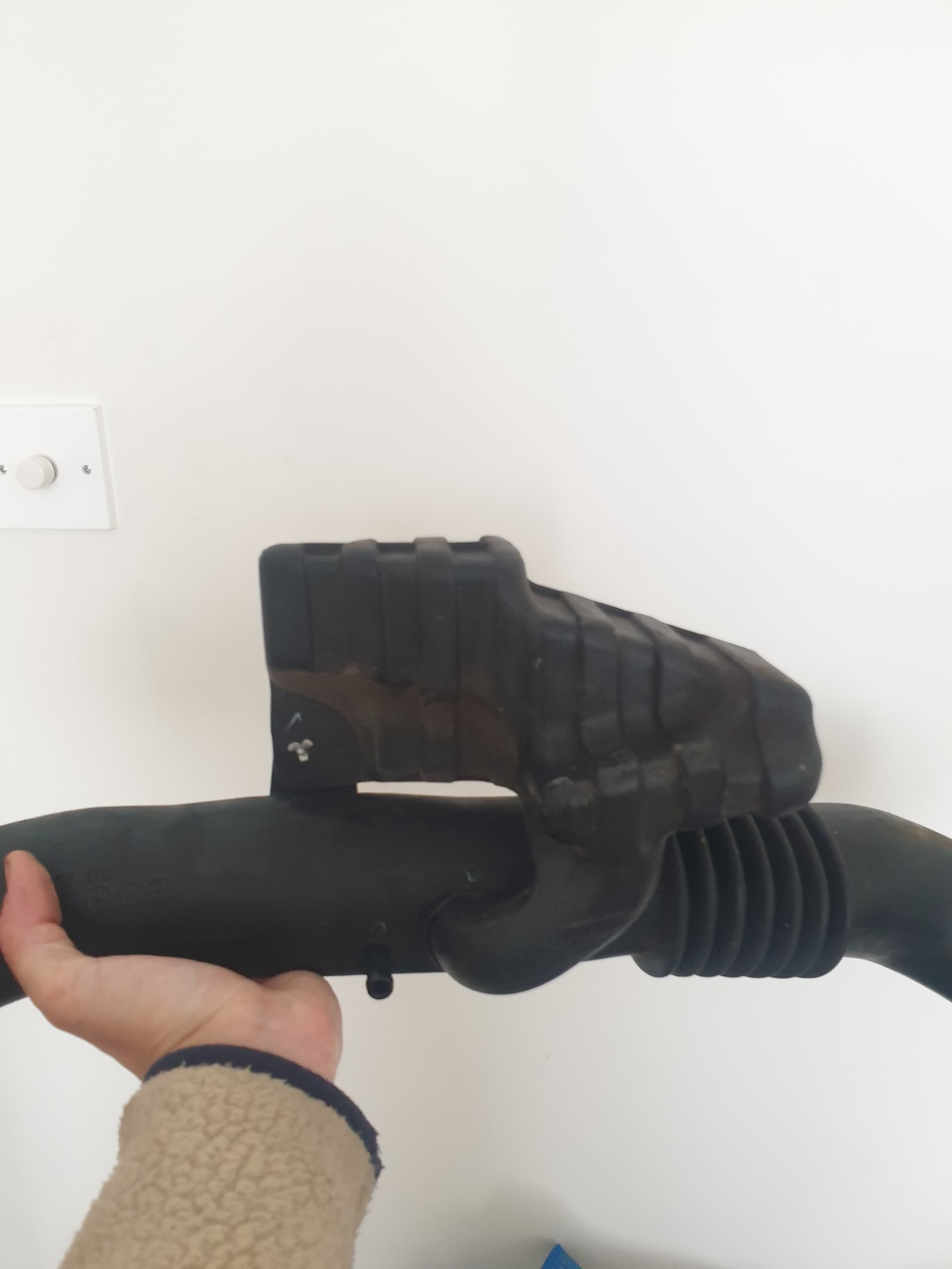

I notice the stock air intake has this box where the crankcase tube originally fitted. Was this serving as some sort of oil catch system?
Cheers,
Greg
An NA car [arguably] doesn’t need one as the intake is always below/at atmospheric pressure, so the crankcase can’t be pressurised via a vent to the intake (this isn’t the case with forced induction). Note, however, that most of the time, your crankcase will be drawing air in through the tube near the oil filler cap and venting directly into the intake plenum through the short ‘L’ shaped tube from the PCV on the cam cover. It will only vent through the long tube under WOT.
I think some people like to fit a catch tank in the small line to keep the intake tract cleaner.
I believe that is an empty air chamber to tailor the resonance in the stock intake tract which improves mid-range engine response. Removing this reportedly reduces mid range power without any benefit elsewhere. (Much has been written about it on various forums.)
The only thing I would be concerned about is any unmetered air getting in where the pipes join.

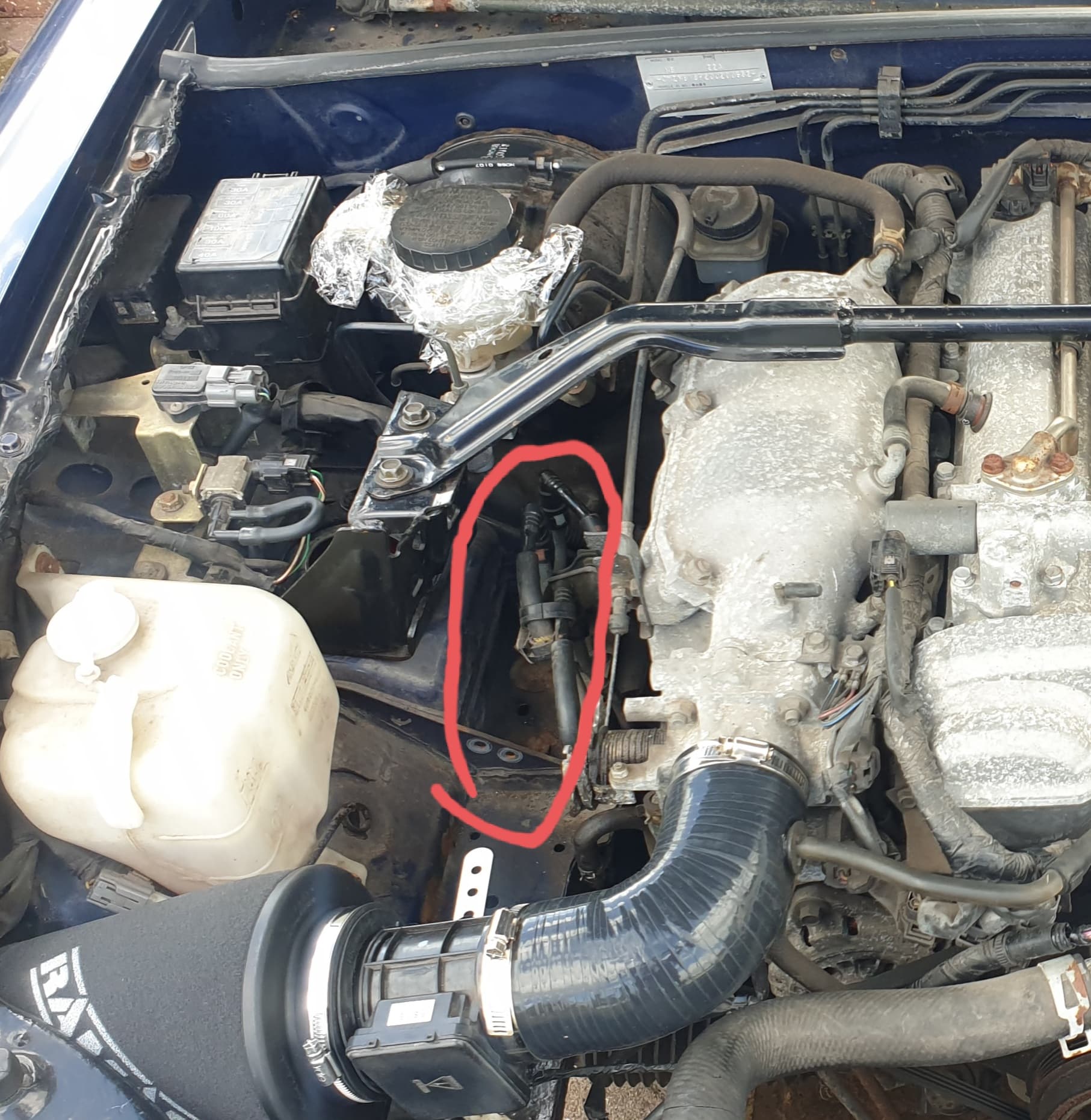

Slightly off-topic question, do you know what the tubes between the intake manifold and strut are? Wondering if i can relocate them in an attempt to clean up the engine bay.
Which ones do you mean?
(The large hose at the top of the photo is for your brake servo.)

The ones circled below:
Not sure. Your fuel flow & return lines will pop up about there, but it looks like someone has removed the evaporative emissions charcoal canister and possibly the EGR solenoid from your car, so possibly hoses that should connect to one of those - I think the fuel tank vent will be one of them.

Someone definitely has removed the evap canister and pipes. I would check which garage did the last MoT and use them next time, as technically removal of the evap. system is a major fail on an MoT test, it is part of the emissions system. I’m a bit surprised that your MIL isn’t on as the OBD-II system ought to register a fault, and that there aren’t any oil leaks as if all the hoses are connected to each other, the crankcase breather should be pressurised !

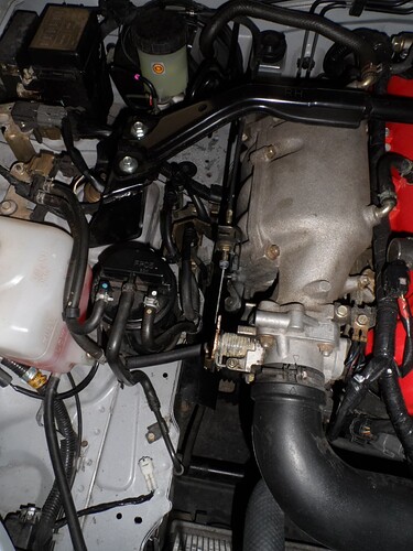

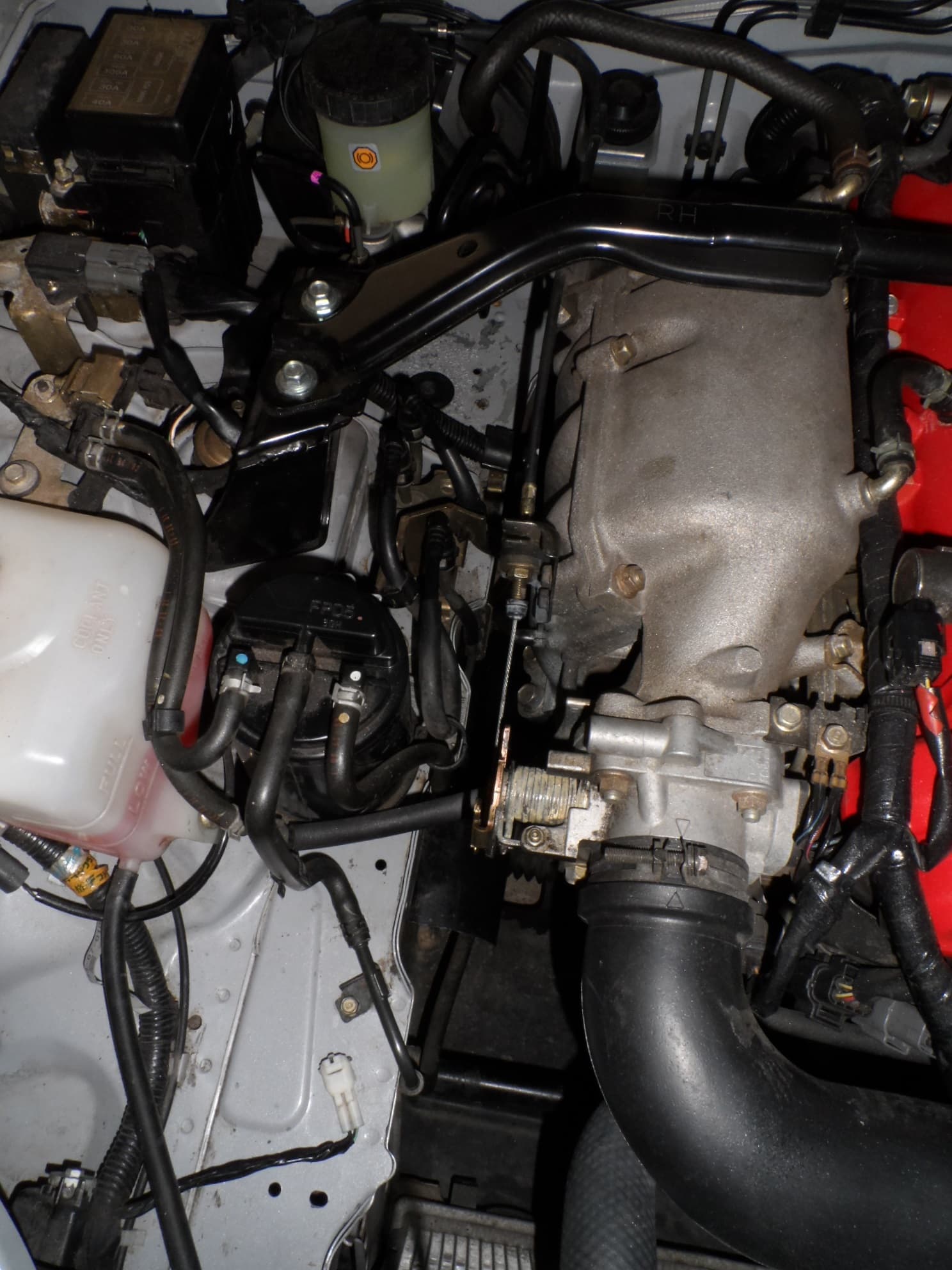

IThis is what should be there :

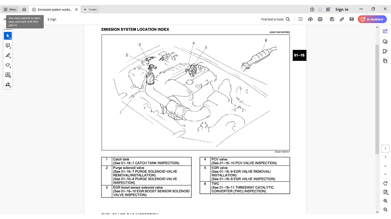

Here’s the workshop manual page. Apparently if you use an OBDII reader you can erase the code that causes the MIL to come on, but in my experience if you have a fault the MIL will keep coming back.
There does seem to a degree of correspondence on various sites about removing the evap. emissions pipes and catch tank ( which is what the thing with 3 pipes under the bonnet officially is, the charcoal canister is adjacent to the fuel tank), but mainly in US states where they don’t do emissions checks.

From what I understand, the MIL light is triggered if the purge solenoid is unplugged - On Greg’s car, it’s still there and plugged in, but the outlet and inlet are looped to each other.
