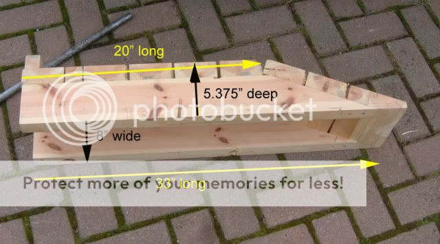

Hi. I have the standard ones. I have made a small ramp out of a single piece of wood that does the same job as the above ramps. I got the idea from my caravanning years!
  Make  yourself a pair, from  100mm x 50mm timber

Nice little joke but I wouldn’t want you or anyone else thinking Yorkshire people are spendthrifts. I made if out of scrap timber from an old pallet that I planed up. Didn’t cost me a penny accept for a bit of electricity and a few screws.{#emotions_dlg.anwhistle}
best idea ever, thanks for that i was going to buy a set of ramps or hire a garage space for an hour, loads of pallets here at work,  won’t even cost for the leccie or brews  : )
 That’s the way to do it, some pallet wood is even planed /dressed up too. Use #8 woodscrews and glue (PVA) if you have some.
