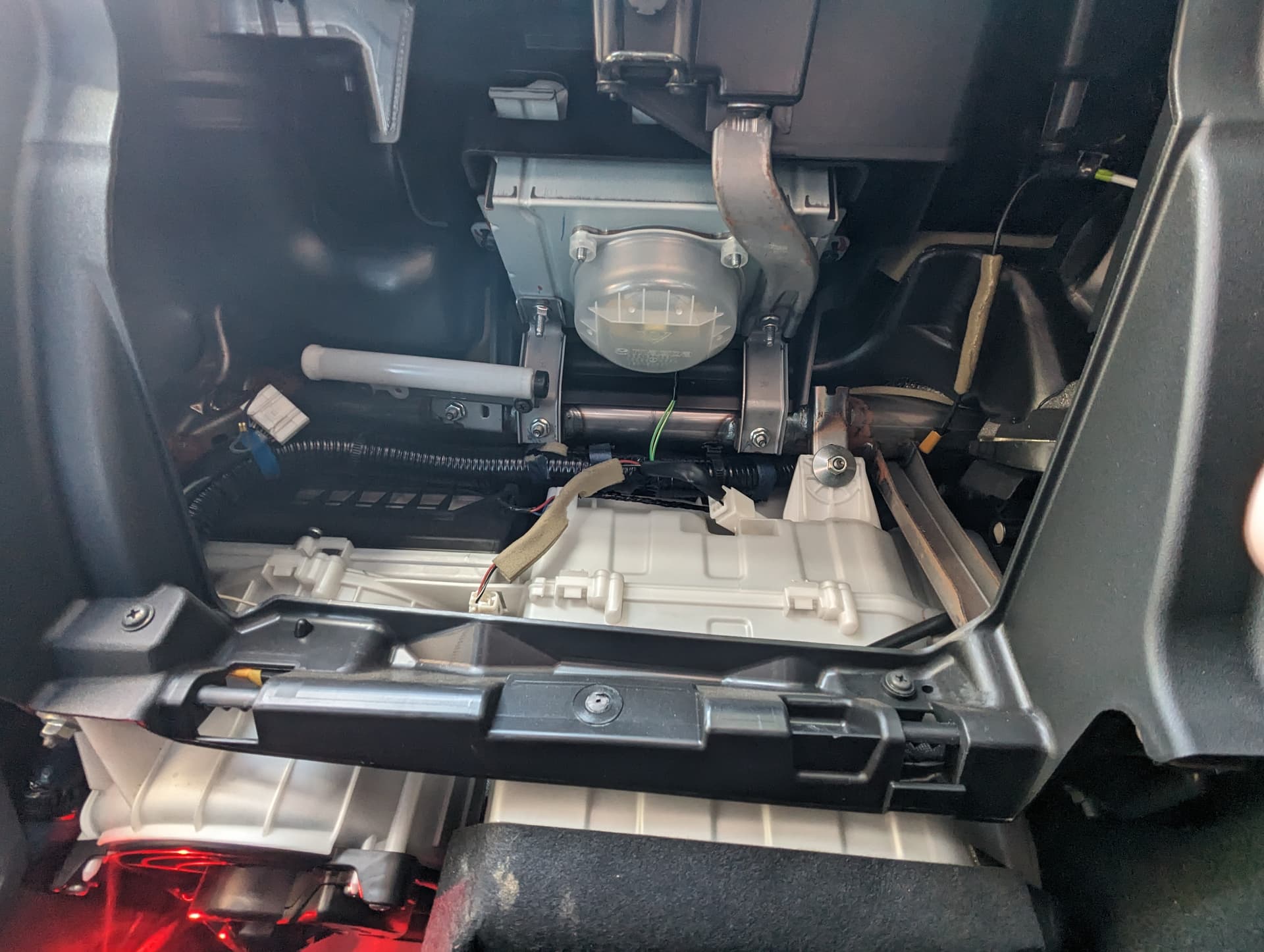

First opportunity to take some time to take a look and seems like there’s no Bluetooth module behind the glovebox.
Strange one, looks like it’s missing, seeing as there’s a spare plug for something…
The plug under the glovebox is something else entirely, mine has it, can’t remember what it’s for.

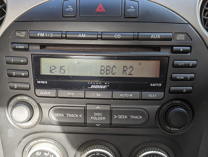

Does your head unit look like the one below, particularly the wording of Bose in the centre? Apparently these were Bluetooth enabled, the later 2 litre Sport Tech and Power shift.
late bose 6cd-3
Not quite the same, is that a US spec? As it shows Sirius button.
This is mine:

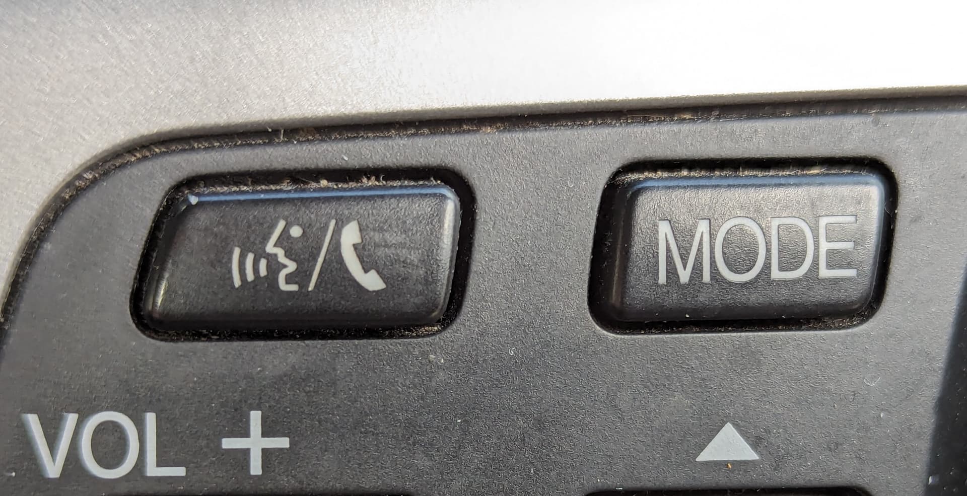

With the steering wheel button (that mutes when pressed rather than beep, which the handbook says it should):

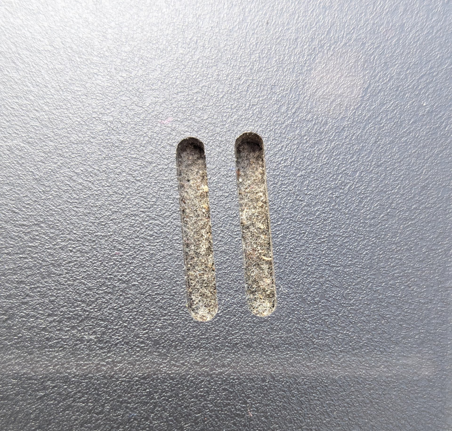

Even has the microphone cut-out on the dash:

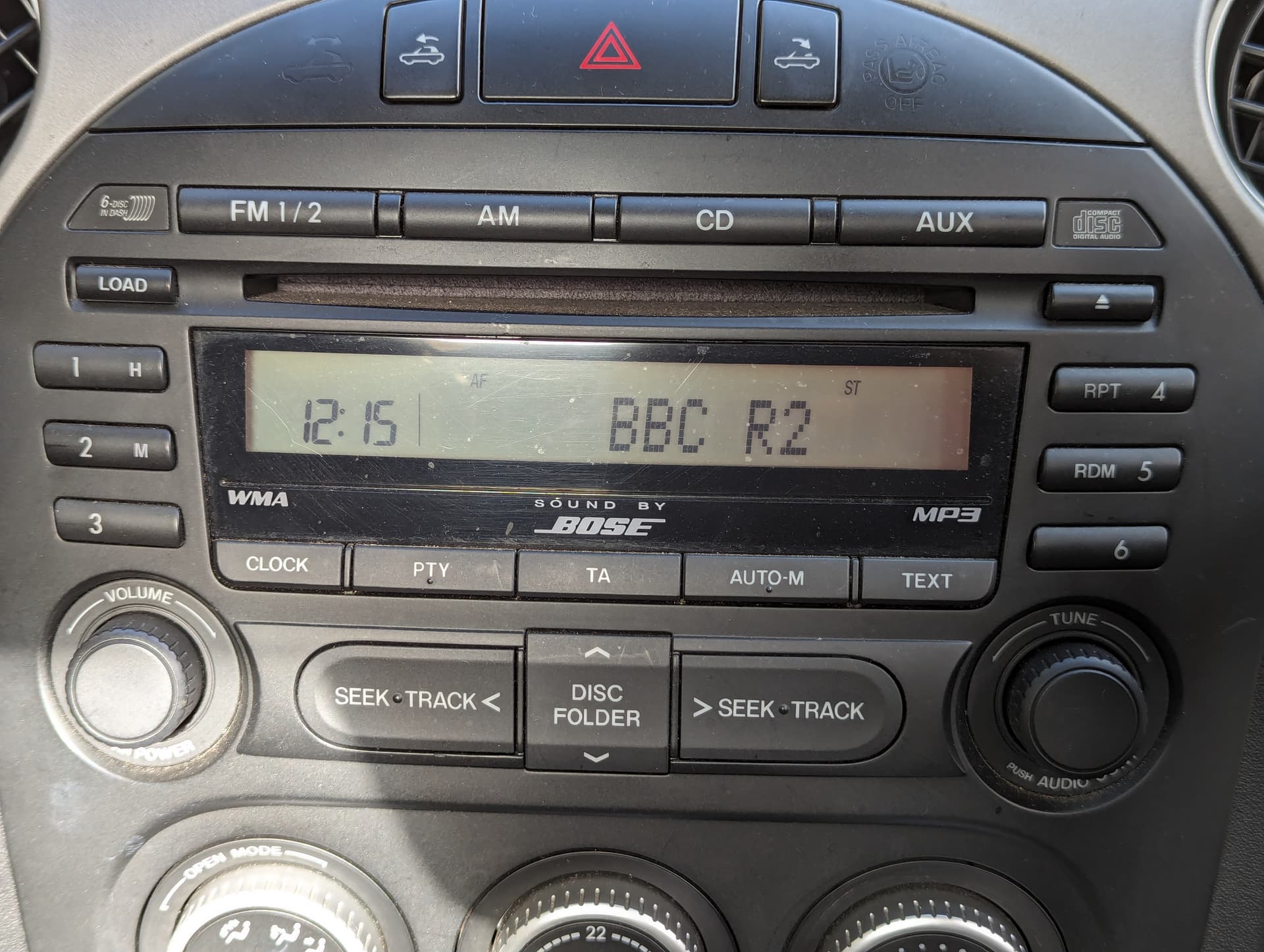

Just wondering if March 2011 PRHT is too early for BT, having the fascia but not the innards, so to speak.
EDIT: March 2011 PRHT Powershift
I’d say you have everything to have Bluetooth in your model/year car with the Bose unit. Question is, was it introduced later to the NC2, year specific when introduced?

I’ve ruled out user error, simply because I’m not even getting to the first stage to pairing phone. IE pressing the voice control button causes the radio to MUTE, which is what the handbook describes it should do for cars without BT. But in their case, the button states MUTE.
