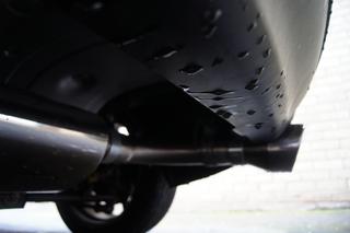

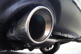

Thanks  - sorry everyone but I’m still confused, especially as Clive from Racing Beat Europe has just replied with the following photo and text:
If you would like to look at the picture attached you will see that the aftermarket Appearance bumper, which is the black part in the middle, you will see it sticks out away from the bumper. It would seem that your one is flush with the bumper. If you look at a slight angle you will see what we mean.
This means you need the normal Racing Beat Silencer ( the price is the same).

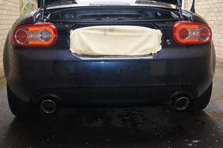

It looks like my car is fitted with one of these Mazda “air dam” skirts:
https://www.mx5parts.co.uk/rear-skirt-unpainted-mazda-mk3-p-2221.html
… which looks like it needs a “standard” exhaust, not an “appearance package” exhaust?
  You don’t have an NC1 with appearance pack, so not relevant
That’s the same as mine, you need the longer tailpipes
Thanks.  Looks like I ordered the correct Racing Beat exhaust (with the extended tips) after all this afternoon

Just to clear a bit of confusion NC2 and NC3 exhausts have longer tailpipes standard
You don’t have an appearance pack diffuser, not in those pics anyway.
Cheers for clearing that up, so the OP has done the right thing and ordered the the longer pipes and I thought the appearance pack was on mine as it is one of the last NC3 cars I am sure it called it this in the sales brochure but I do know the 25th AE has a sport diffuser that protrudes the same as mine and has the fins on.
Yep the 25th Anniversary model has the extra diffuser trim piece, your rear bumper is stock Laughing
