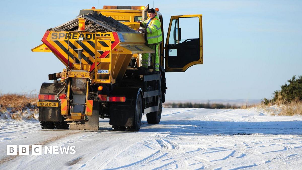

That dirty residue is 260 million years old.

Thanks for the BBC article link - I’d never thought about where rock salt came from, or how old it might be - now I know :+1: 260 million years old is pretty old. However, I was in Anglsey over the summer and the Marquis of Anglesey’s Column stands on rocks circa 570 million years, so it’s all relative. Anglesey was near the South Pole back then too :polar_bear: Oh and road salt rusts cars no question - my first NBFL was effectively melted by the stuff.
