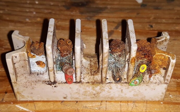

working on the project today the lights power goes out RCD keeps tripping and trips the house RCD as its on a spur from the house after around 2 hours of hunting down the prolem I come across this …
The old incomming connection that goes to the garage RCD box with the Circuit Breaker’s has slugs in there they where a little fried :rofl: now sorted and sealed back to working on the car … :laughing:

That corner looks like it may have been damp recently, which may be your cause.

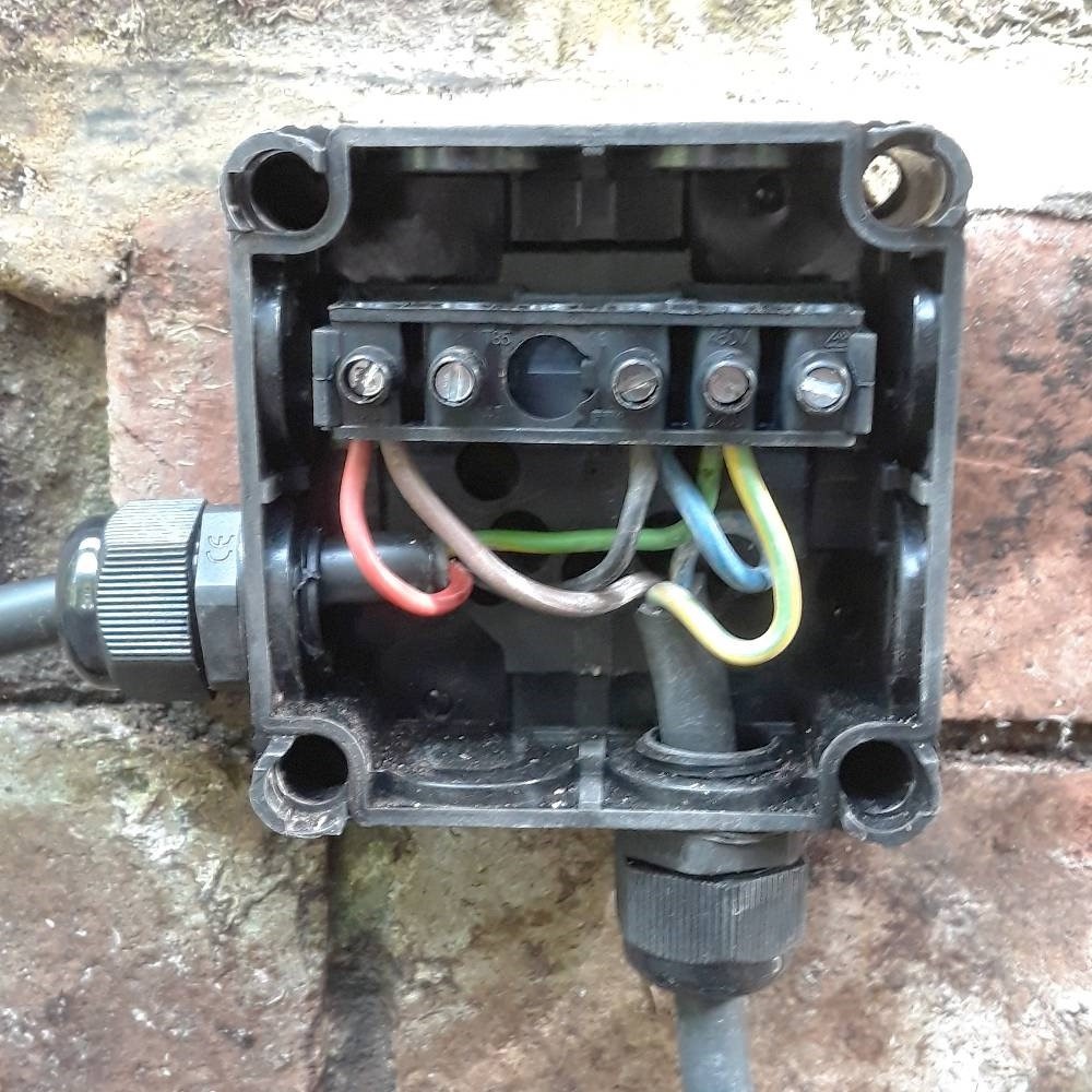

If you need a genuine waterproof junction box, try this Black Wiska I needed for my 10Amp drainage pump.
After I took this pic, I also gave it’s insides a spray of the classic WD40 (Water Dispersant 40); if it was good enough for several kV in my old Mini’s distributor, then a mere 240V would be nothing.
The original “waterproof junction box” installed by a sparky thirty years ago finally managed to corrode the Neutral wire to the pump open circuit; so the pump didn’t run and last year my garden ended up flooded after prolonged heavy rain. Those terminals in the pic below were supposedly “Brass”! Strangely, it did not trip the RCD.

nope deffo the slugs caused this yes there is a damp patch but it was the slugs at fault … new box will arrive tomorrow nice story by the way… :wink:
yep new box on the way arrives tomorrow…
Whoops, skipped a step there; Damp wall > highway for slugs > entry to junction box > kaboom!

yep see what you mean the connection box is around 4/5 inches from the door and the drain down pipe is the other side from the roof when the wind blows there’s a little kick back in the winter so that’s there route in spread that area with some salt solution so hoping that and the new socket will stop them trying to steel my electricity … :joy:
