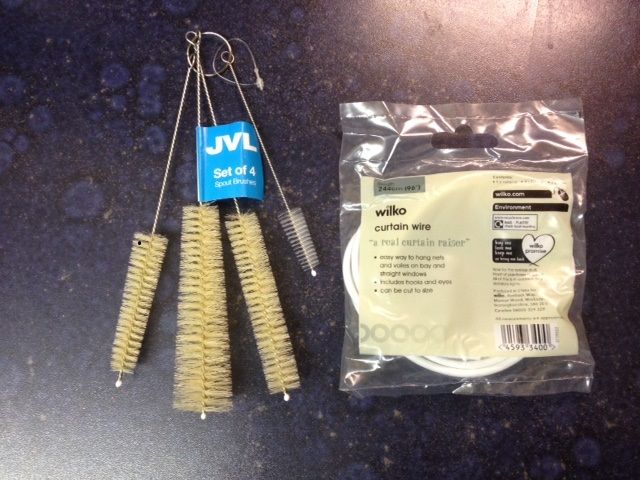

Hi all, I’ve been meaning to buy a trumbone brush for cleaning the roof drains on my MK1 but just havent got around to it.
At the weekend I was wandering about the local shops and came up with a cheap DIY alternative and thought I would share it. Someone may find it useful. In Wilko I bought a lenght of curtain wire for 60p and in Robert Dyas I got a set of 4 spout brushes, £1.69. I cut the wire loop of the end of one of the brushes and screwed it into the end of the curtain wire. I made dam sure it was well and truly jammed in to be sure it wouldn’t come off in the tube ( maybe use glue as well ) and there you go, a drain cleaning brush for £2.29, and three brushes left over. Just tried it this morning and works a treat.
Enjoy.

Even cheaper is a wire coathanger. Too much brushing with one of these pipe cleaners can dislodge the drain tube.
I use one of the trombone brushes - but also use the thin end of a carp rod - the drain hole next to the petrol cap is a bit stiff to get the brush through but as the rod end goes through I know any water will as well
I spray my ‘trombone brush’ with silicone lubricant each time I use it, to help avoid this.
