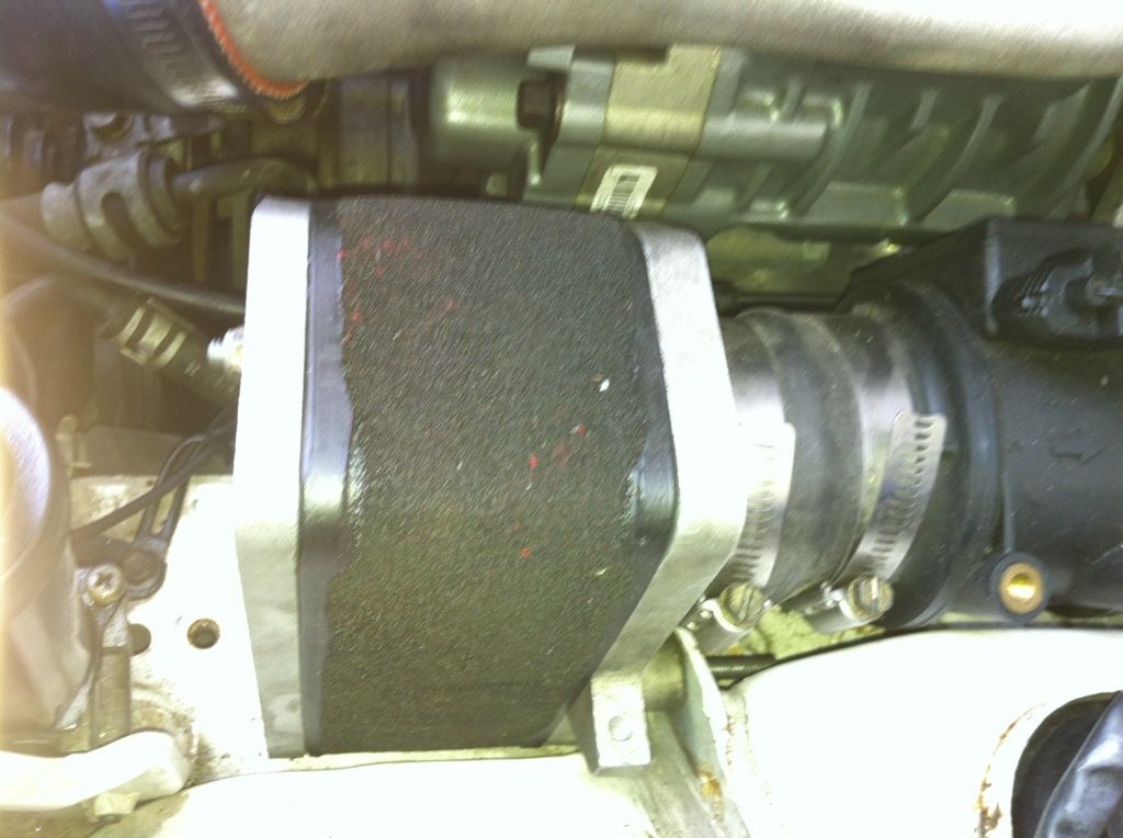

Haha Mal, at the moment the air filter on my supercharged R2-Ltd is one of these below and the J2-Ltd has an un-drilled airbox (for now) with a Pipercross foam filter installed, how times change. It is true that a drilled airbox with a standard Mazda filter does sound a bit odd, but with a decent panel filter like a K&N or Pipercross they sound really good.
