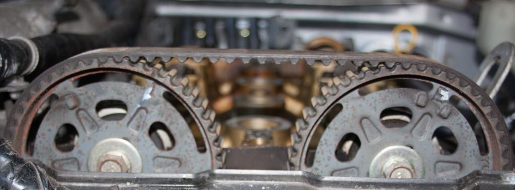

Do not do as advised with the broken pieces of belt behind the crank pulley as I know to my costs.
Take off all the cam belt covers, three if I remember to make sure there is no parts of the alternator or power stearing belt stuck between the cam belt and the cam wheels.
This happened on my MK2 and the cambelt jumped three teeth.
As Eddie said, plus - if you bought the belts from MX5 parts, then you may struggle to get them on. We had to loosen the adjustment bracket (on the engine) so we could get the power steering belt on. May also be necessary to do the same on the alternator belt, but we had difficulty locating the pivot bolt, so it’s not done yet.
Good luck removing the shredded belt. Check the setting on the cam belt before you refit the cam belt covers, just in case. Hand cranking the engine is going to be a tough job, so Eddies idea sounds better to me.

The way the broken external belt gets behind the cam cover is that they are forced behind the very thin section of cover that is at the crankshaft and mine was damaged and had to be replaced.
Your garage was lazy and they have put your car at risk!
