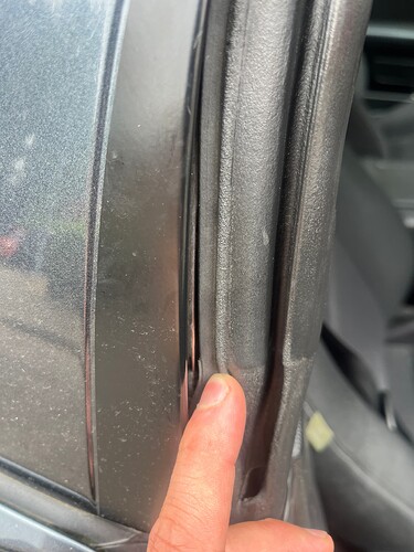

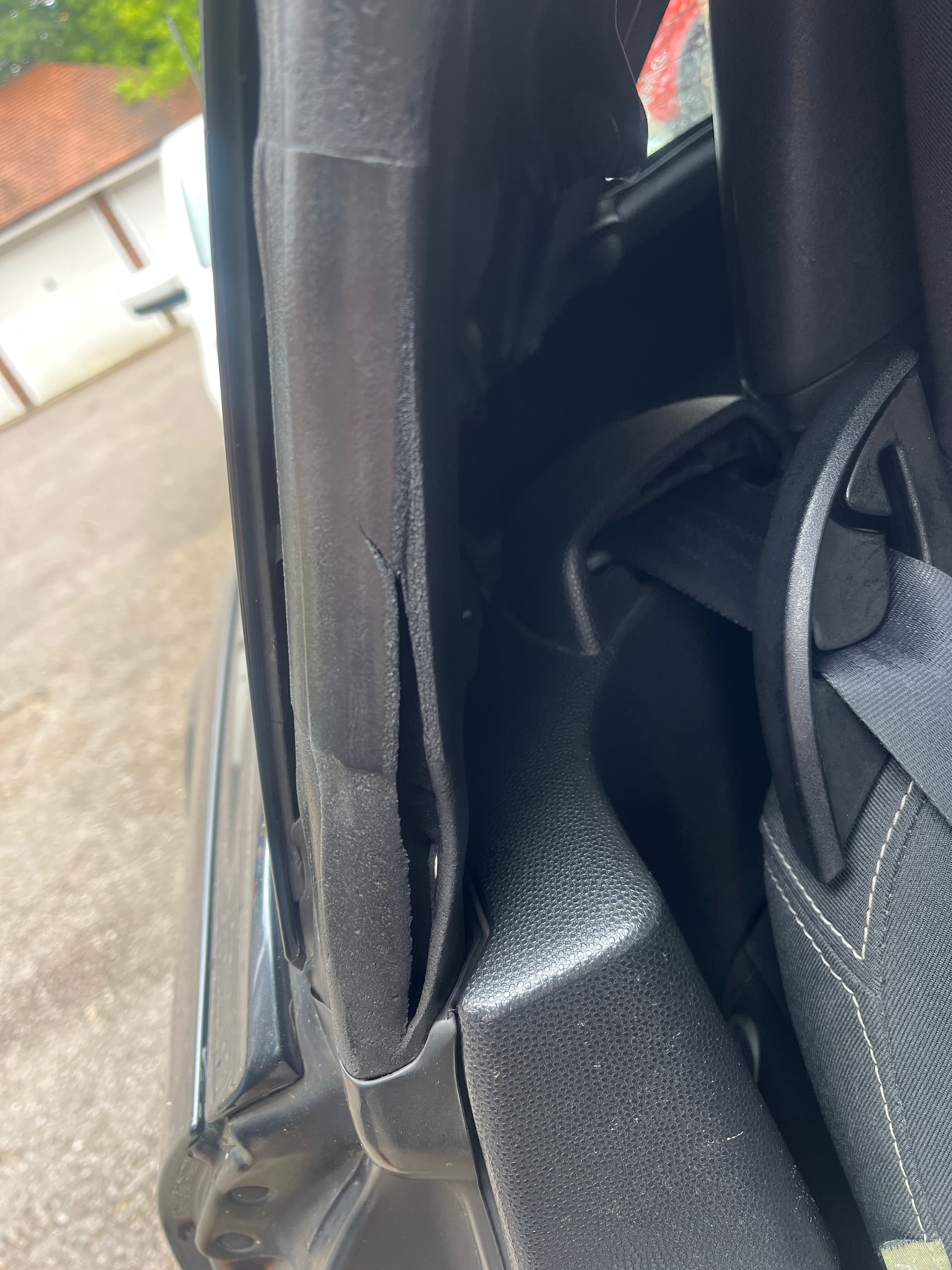

Hi everyone,
Hope you are having a great week.
I noticed today after getting out of my mx5 NC PRHT that the B pillar rubber seal is in a very poor state. I would appreciate your thoughts on the potential issues it can cause, also if you know where to get a replacement. I haven’t seen one on eBay or even MX5 parts for the PRHT.
Many thanks. Have a great day.
Dan
That rubber seal is on MX5Parts, but it’s the expensive one that runs across the top and down the passenger window too. I would think that isn’t fun to fit either.
https://www.mx5parts.co.uk/roof-seal-retractable-hardtop-mk3-35
I think I would try some type of glue that you could use to stop it getting any worse? At least while you consider options.
Thanks Japester. I just had another look. You are so right. Well I guess I’ll get some rubber sealer, try to patch it up and hope for the best.
Have a great day
