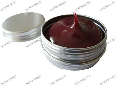

Use the specific silicone slider pin grease, or
Use “Red Rubber Grease” for the slider pins.
As in Castrol.
A small tin on eBay as an example.
