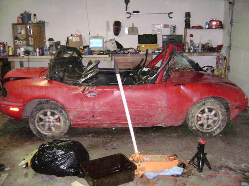

Rollbars should be padded with SFI padding, which is firm enough to cause concussion unless you are wearing a helmet. You are more likely to be rear ended in a MX5 than to roll it, so by fitting a rollbar into a road car, in a hard hit, you have increased the risk of your flying doll like body smacking into the rollbar; few people actually pad these. The actual examples of stylebars “mousetrapping”, after 15 years of observing the online debate, is stunningly small. One proved to be misleading; the Alumex bar was bent during recovery operations; the driver was killed instantly when his head hit a loose stone during the roll, so a rollbar wouldn’t have saved him. Driving with the roof up might have. The well known photo:
Strangest roll ever, with the windscreen bent forward. I am still not convinced that all the damage was caused by the roll, and rather happened during the vehicle recovery. The owner walked away relatively unscathed, hence the photo in his garage.
