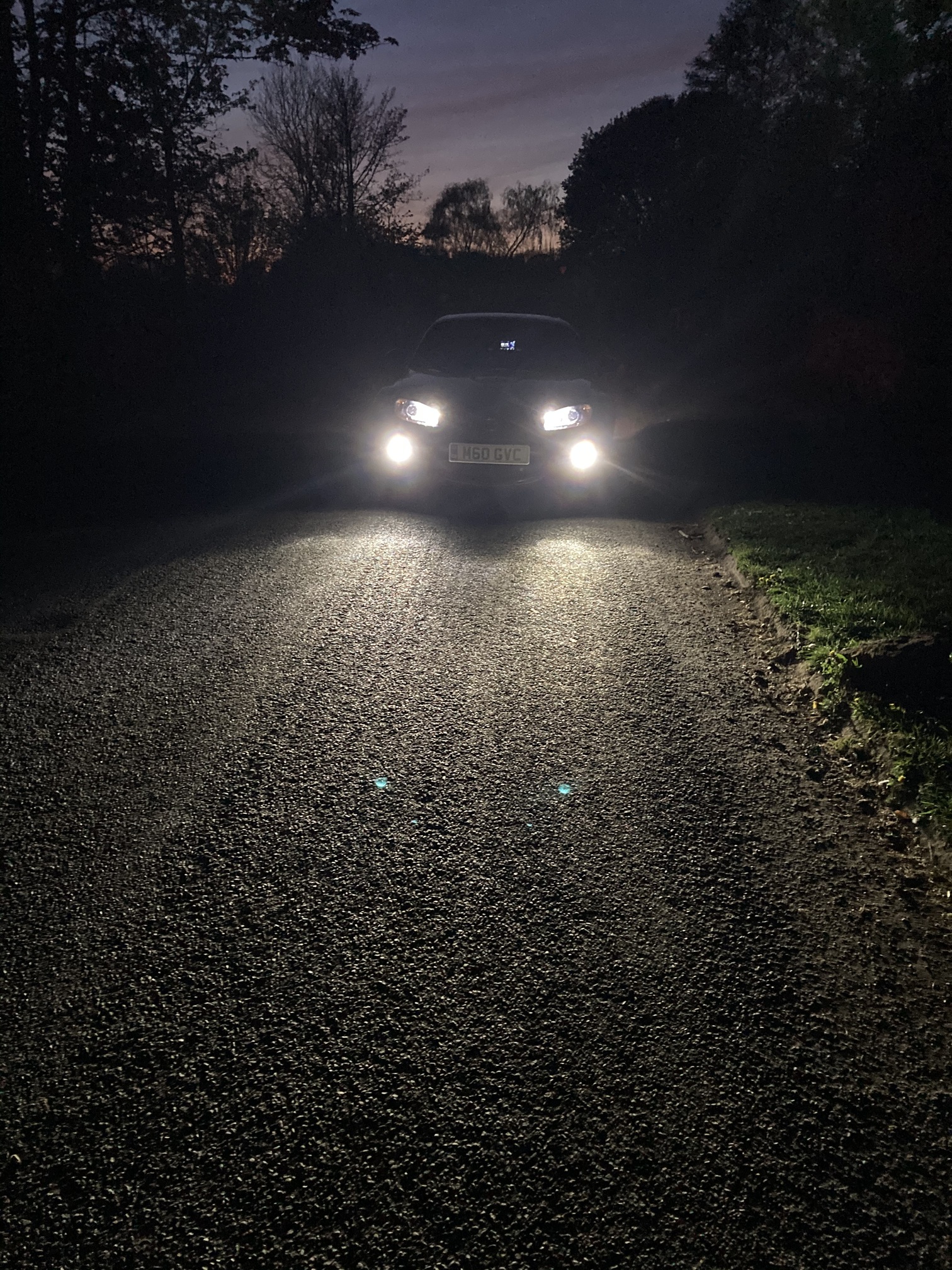

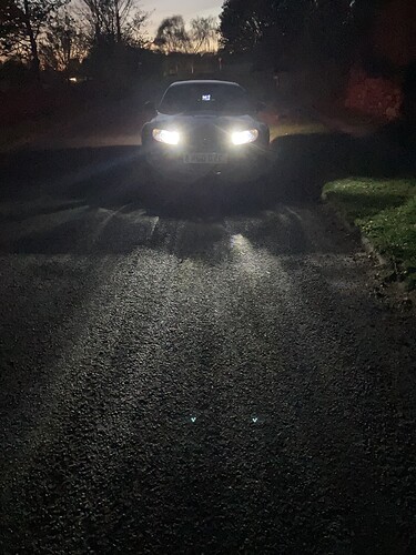

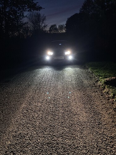

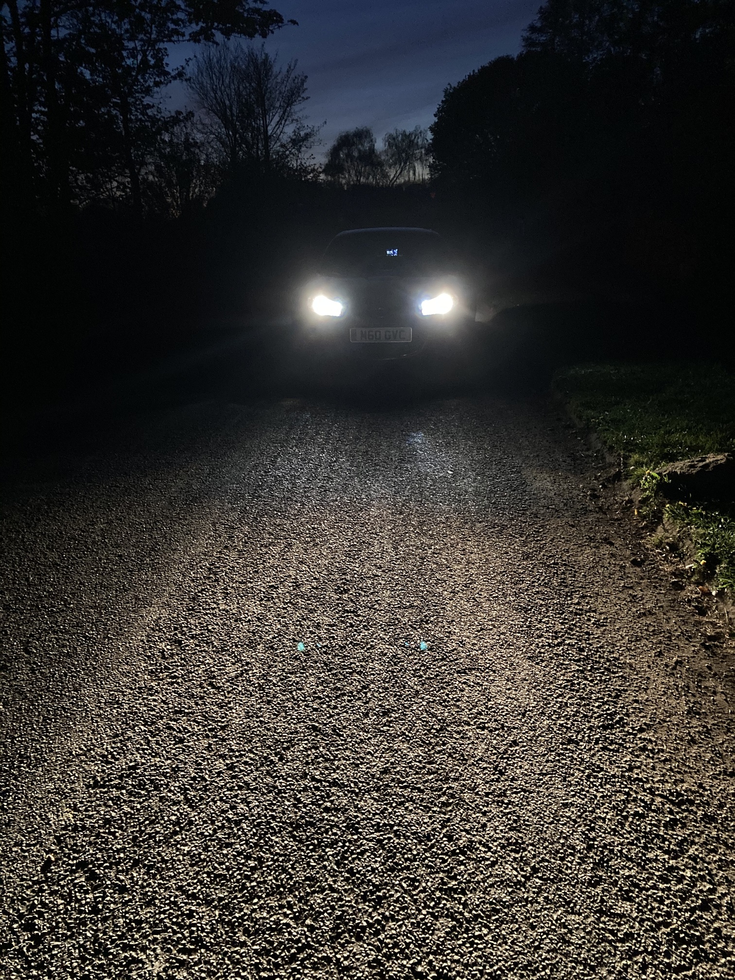

Okay, quick drive in the dark and yes seems to have more white light on the road.
Both dipped and indeed main beam.
The H7’s do seem to have the “Whiter” light against the standard yellow as can be seen against the LED H11’s.
Not the greatest quality photo’s, but you get the gist. :+1:
Perhaps that’s what I wanted to see, who knows… :man_shrugging:
All road legal, so happy.
  1. Just LED side lights.
  2. LED side lights and LED H 11’s.
  3. As 1 and 2 plus The Philips H7’s as above post.
  4. Just the Philips H 7’s.

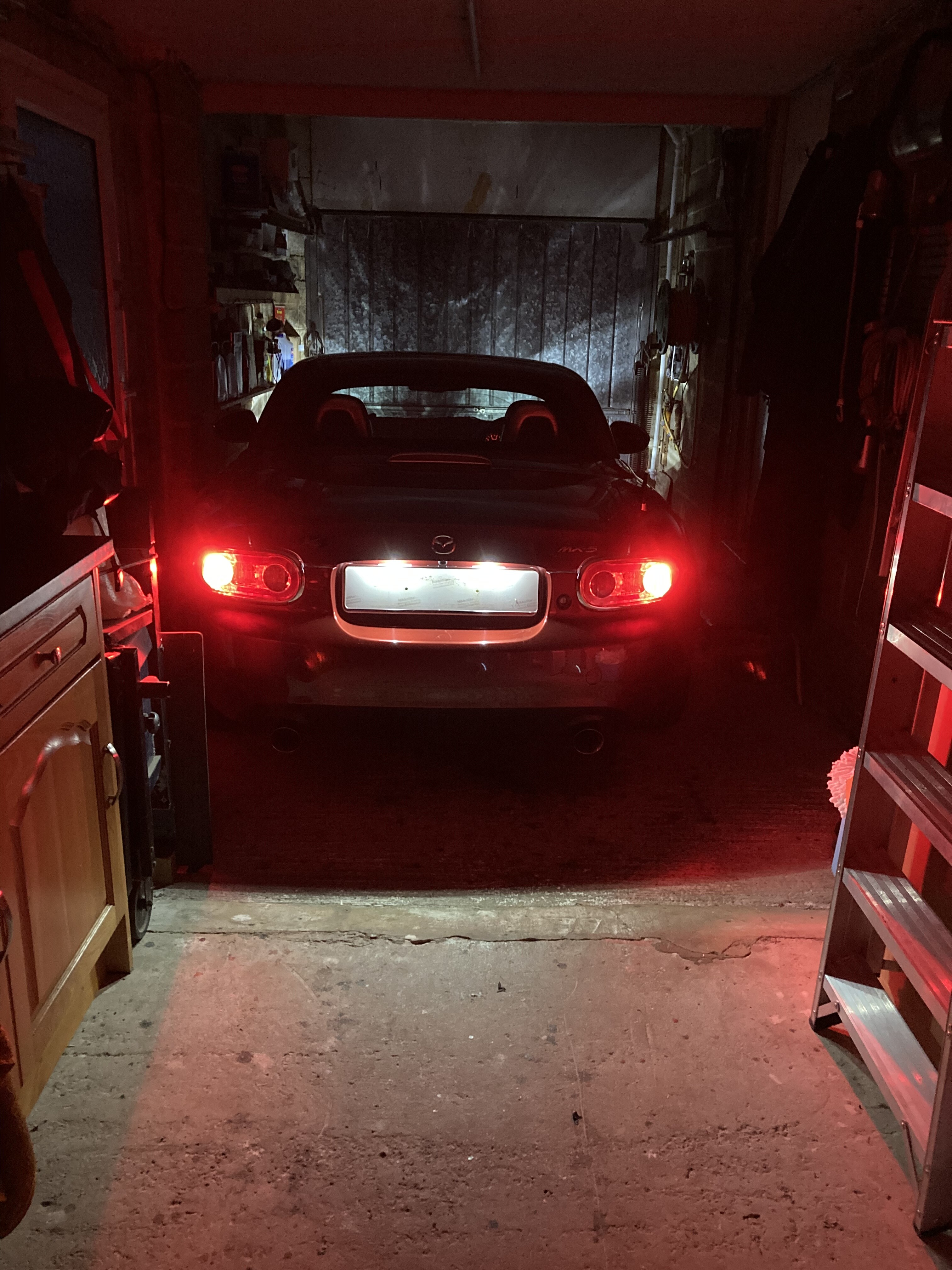

I researched LED Brake/Tail light bulbs and found these.
A little optimistic, but they arrived promptly, easy to fit and a VAST improvement on the halogen bulbs.
Offered £12 and was accepted, (try lower?).
All the best. :slightly_smiling_face:

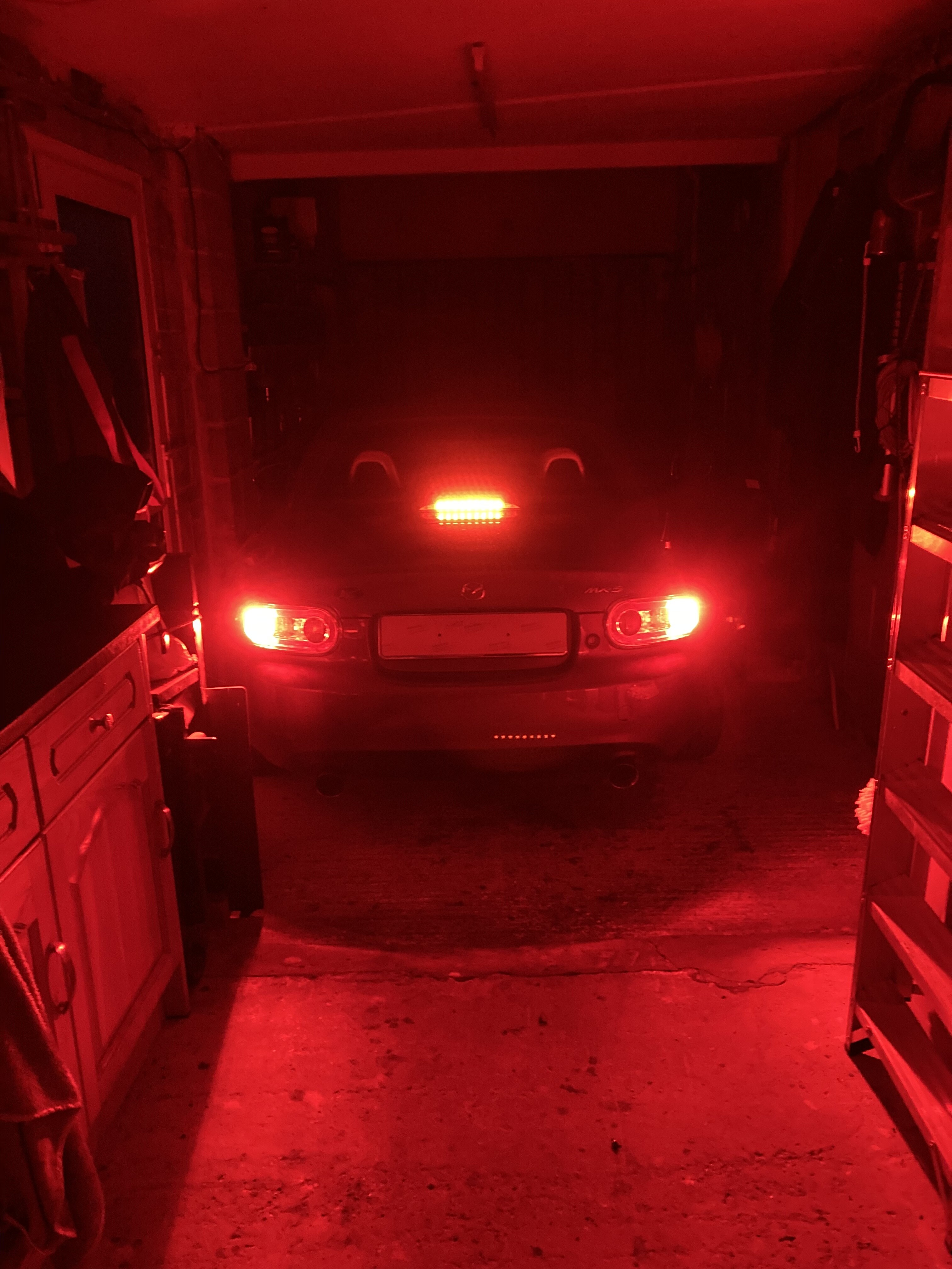

I can attach some after pictures and you can perhaps compare with yours?
They are much more defined and indeed brighter though. :+1::slightly_smiling_face:
Soda law! Yes please to the after pics though!
In the garage I know, but BRIGHT!
The centre one is Led as standard, so now a matching set. :+1:
