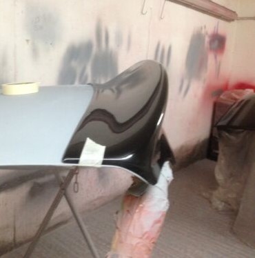

see below for a quick pic of it
ductail (2)
Any advice for or against going down this route?

Dry fit first to check the fit is ok to your boot lid, as in the photo posted. Once you have done this use the tiger seal sparingly to avoid it squeezing out and fit and clamp it in place until dry. If it squeezes out clean it off before it dries.
This looks like the one on Ebay, I am considering one as well. Are you painting it or leaving it black?
Yes, its one of those on eBay. I was going to leave it black. Its finished quite nicely as it comes and it sits well with the black roof and wheels. Might take the bootlid off the vehicle to install it aswell.
