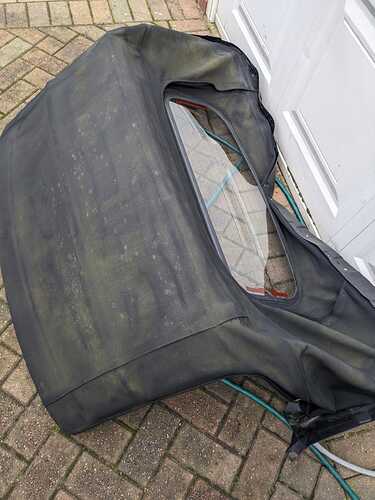

Yes it’s me again. I dyed my softop yesterday extremely hot weather but did it in the shade. It’s come out streaky. Is there a certain brush I should be using. Maybe I should do it when it’s cooler. Also I don’t understand the WET concept. Help please :pray:

Just had a look at a sales video Bing Videos where he is dying a plain white piece of canvas. He implies that you can reverse the colour back to the original. It appears that it is water based and requires a ‘proofer’ to be applied after the dying application. Is this the product?
Renovo Soft Top Reviver is the best product. Applied quickly so that it keeps a wet line and without overlapping brush strokes.

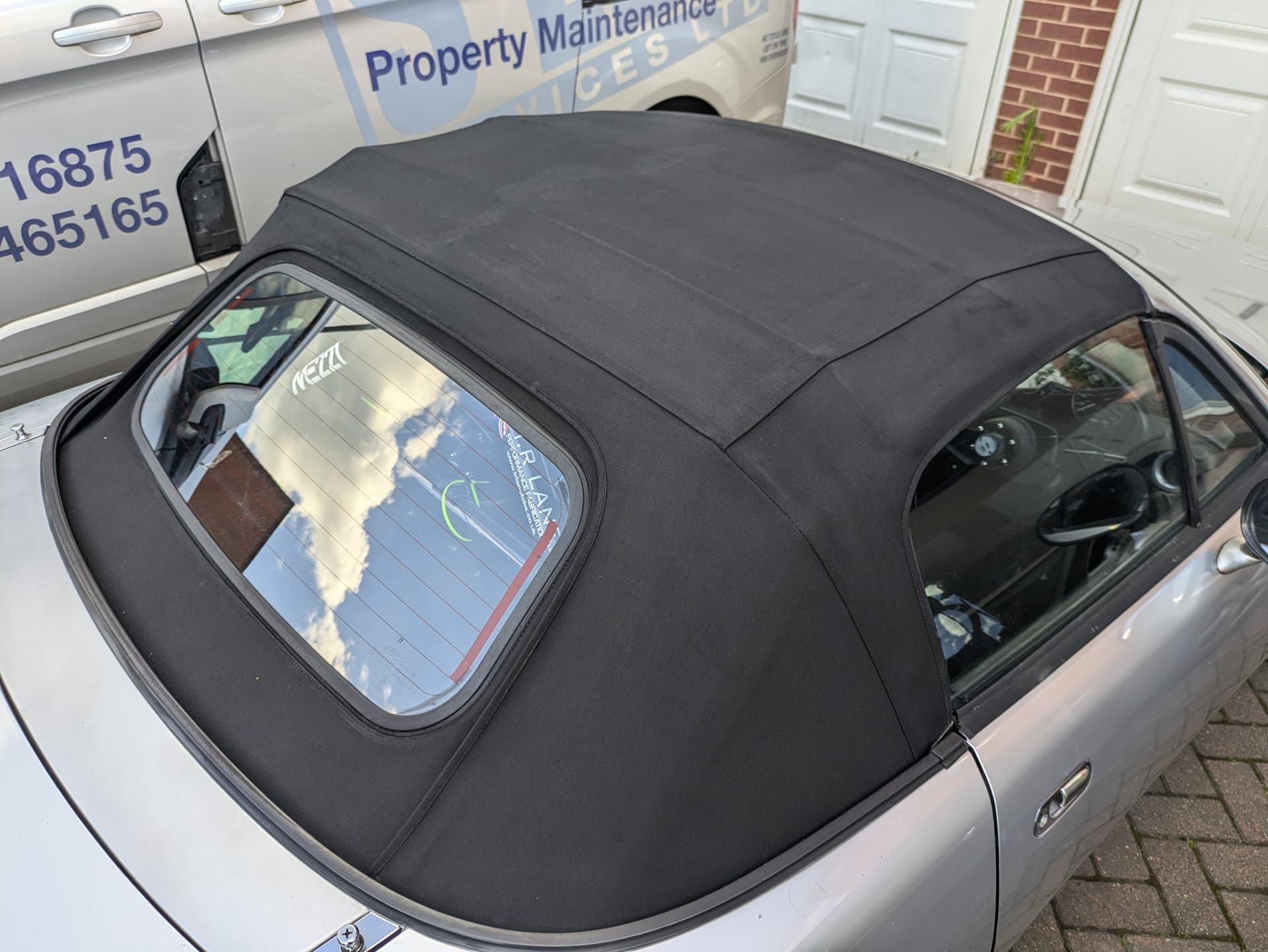

Just plastered it all over to be honest, with no thought as to keeping neat lines or anything.
Keep a damp rag close to hand for any big splashes, but they come off the paintwork with polish anyway.
I don’t recall any major issues.
Renovo
Looks great
