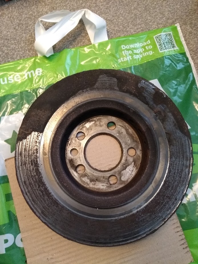

I’m just having a look at my brakes. Like yours, the car’s been standing and my discs have started to rot away. The problem I’ve found with eBay is that a lot of the sellers of MX5 parts use stock photos for parts which is absolutely useless. If I’m buying any part online, I need to see clear photos from all angles of the actual item I’m buying. Putting a picture up of a good condition part then selling a worn out part in it’s place isn’t good for business.

Just replaced the discs on my other car which had stood for several years and condition was awful. The MX5 discs aren’t quite that bad but on their way.
I agree, that one is awful, but it is not “rot”. The gouges look like someone has used pads well beyond their change-by date!
Be that as it may, they are not MOT-able :slight_smile: :slight_smile: :slight_smile:
David
All four were the same, this one just the worse. The car had stood for years, the corrosion finally lifting the top layer of steel so it just flaked off. Not just my discs, a lot of owners have had the same thing.
An interesting explanation, but what caused the circular patterns on the disc?
David
