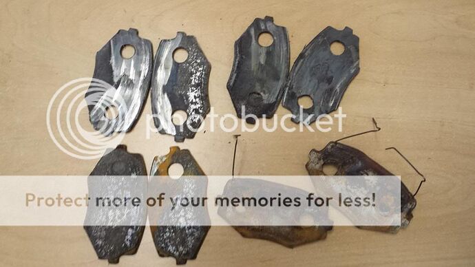

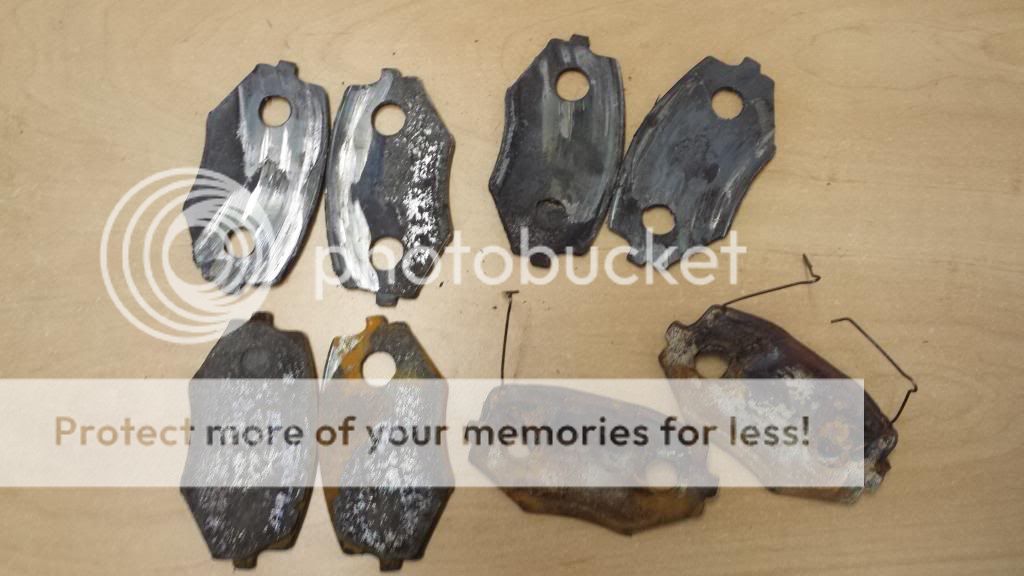

Got our moneys worth  .     These were green stuff !    The 20 minute sessions at blyton took there toll in the experienced class when giving it full beans.
I must say they didn’t fade right up until they wore out.  We had spares . The rusty set were left out in the rain, not thinking they would be photo’d.
So that’s what the middle pedal does… Either that or someone left the hand brake on…
