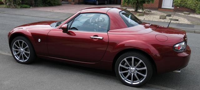

I think from your description you’re talking about Copper Red, not sure if there were any other Red colours used.
As to lovely light blue, perhaps Ice Blue would be more your idea of a light blue which was one of the colours the Niseko had.
This is the copper red you mean.
Compared to the true red (mine) in the pic below, which is parked next to a copper red one.
They also do a velocity red which was a launch edition colour and later editions, see link below.
