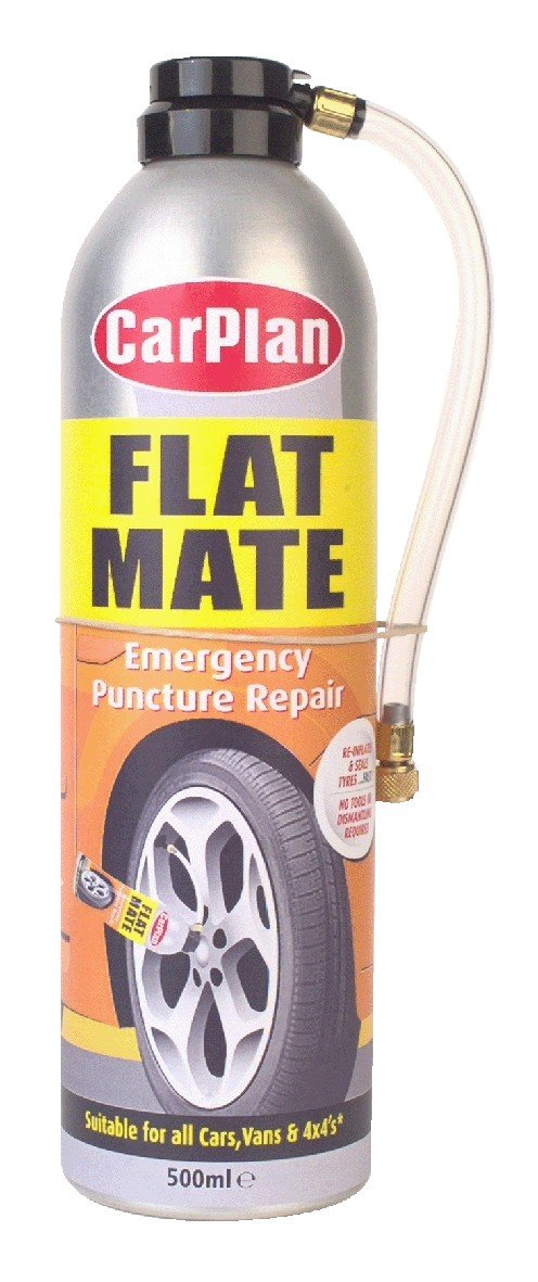

We’re going on a little trip this summer and in order to pack more kit in, I’m thinking of ditching the space saver and putting one of these in the boot:
Amazon Link
All the reviews seem to be “I hope I’ll never have to use it” - well, yeh, me too, but I want to know if anyone has had to use it, and if it worked sufficiently well to enable them to limp say 50 miles to get their tyre repaired/replaced.  I am aware that if we get a critical blowout/valve failure etc it isn’t going to help, but I have AA cover too.
Any thoughts/comments?

I have never had the need to use one of these emergency repairs but hopefully they work if the puncture is small enough.
I note your comment about having AA cover. I think you will find that all the major motoring organisations give reduced cover/service if your car is equipped with a spare as standard and you are not carrying it when you get that puncture or blow-out! I think you should read the small print or phone them up and check!

 There are three  reasons for these kits 1. Cost saving.  2. Weight saving. 3. Boot space saving,   My recent experience on a very new, 2013 reg, daily vehicle underlines this.  Got a puncuture, followed instructions with the manufacturer’s kit -  didn’t work. Second attempt tyre stayed up for 1.5  miles then flat agin.  When approved tyre expert and van arrived first comment  “Not surprised, we are often called out to sort out these emergency repair kits that just don’t work in 60% of cases”  My plan for the future and my advice  - carry a wheel with a tyre on it even if  it’s a space saver.  Interested to hear other’s experiences!

I used one of these repair aerosols when I had a puncture (nail through tyre) when I was in the Loire Vally a few years ago. Got me home - about 450 miles with speeds up to 65mph with no problems whatsoever. The only downside is that some tyre places don’t like repairing the tyre afterwards mainly because it’s a bit more difficult finding the hole plus the fact that they want an excuse to sell you a new tyre.

I had a puncture a few years ago in France, tried the Aerosol that i was carrying instead of the spare, it didnt work.
Had to be put on the back of a recovery truck and taken to a tyre place to have the tyre replaced, split on the side wall apparently…
The French highway patrol guy, who didnt speak English and we didnt speak French, kept on looking for the spare wheel, which we didnt have.
We were covered by breakdown insurance, who paid for the recovery, we had to pay for the tyre.
Also had a puncture last year going to work, 4.30am on the motorway.
Again, aerosol didnt work, but i had my space saver in the boot, so i had to change it, in order to carry on…

 No, it is because you have already destroyed your tyre by running it flat or at low pressure before you put the stuff in.
I could not agree more. Once a tyre has been run flat the sidewalls are ruined by running on the rim.  I would never trust such a tyre again.  I would examine your tyres very carefully well before departure, many punctures are caused by metal fragments, thorns etc. which have been embedded in the tyre for a long time.  A boot rack and spare tyre would be my solution.
Regards  Geoff Peace.
No, the sidewall wasn’t damaged. They said that the liquid from the aerosol covered the entire inside of the tyre and made it impossible to find where the puncture was and they weren’t prepared to clean the tyre up before repairing it as it was too messy a job !
Sorry that I am taking exception to this, but that is not an excuse to sell you a new tyre, but that it is a totally practical reason. The gunk is horrible, it spills all of the tyre machines, covers the floor and sets making a horrible mess you cannot remove. The design of it is to find holes and seal them. It would indeed take an age to clean the tyre, use lost of consumables and time (labour), which you wouldn’t want to pay for, to attempt to clean it up and then depending on just what the puncture was, not even be able to find it. A leak test won’t as the hole has sealed. So you run the risk of them putting a patch on something that is not the actual leak and so the tyre is not repaired. So, actually it is a reputable outfit that does this, not an excuse to sell you a tyre. I would make more money for a puncture than a new tyre so there is no incentive other than doing the right thing, to fitting a new tyre.

Very interesting. That means the debate is not about do these aerosols work (which depends on the type of puncture) but do they ruin your tyre. I can understand that  neither the aerosol makers or the car manufacturers who supply these cans are going to say “this may or may not work and anyway, you’ll need a new tyre” but it sounds like they are bad news.
 I thought I was being clever by ditching the space saver to gain boot space and lose some weight but it seems that is rather foolhardy. the moral must be keep the space saver unless you really have no option.

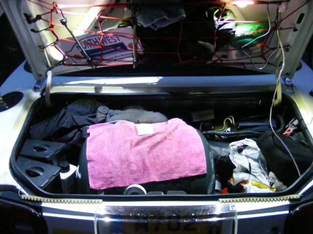

I had done about 6 trips with a MK1 and no spare then got a MK2.5 sport so had a spare. Now gone back to MK1 and
I’m not so sure leaving the spare at home is a good idea anymore, so it’s space saver and less luggage for me.
