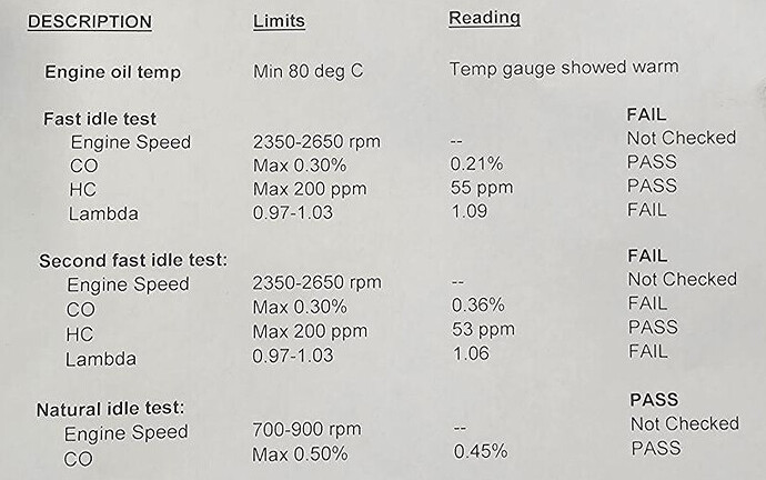

Any advise on the below emissions test. MOT is expired and I’m struggling here.
Changed the lambda, had holes in the rear box welded, new air filter.
1st time round it failed on CO at 0.63. HC was very low. Lambda was in the mid range.
This time →

High lambda number means it’s reading a lean condition but high CO means it’s actually running rich
So I suspect a pre cat exhaust leak meaning the cars lambda sensor senses too much oxygen, triggering the ecu to inject more fuel to balance it out hence producing excess CO . you should also check the vacuum lines for any leaks as unmetered air will cause it to run lean. Check the spark plugs to see if it’s rich or lean. Black soot means rich.
