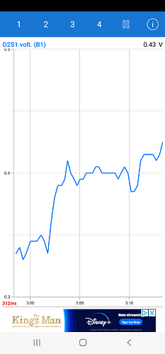

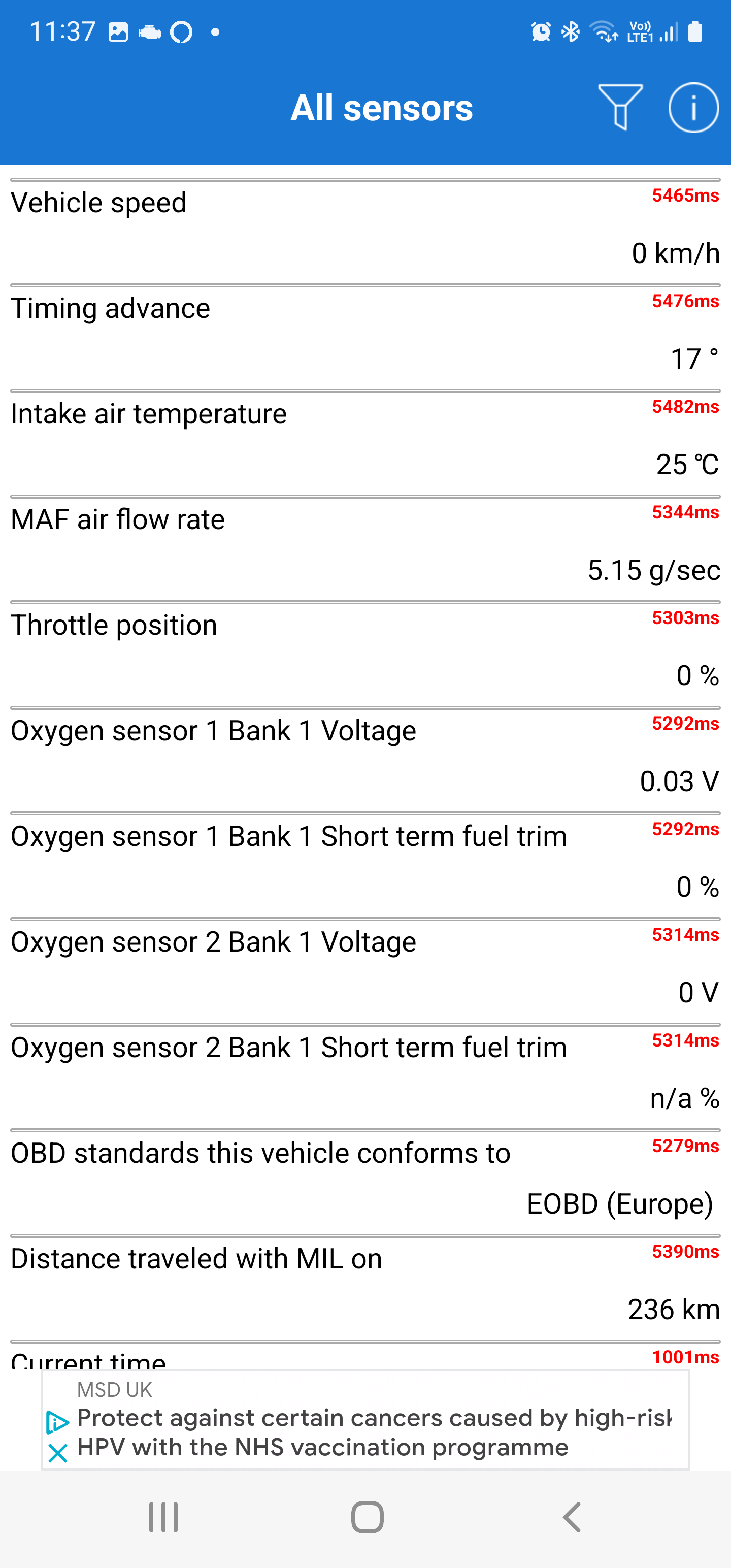

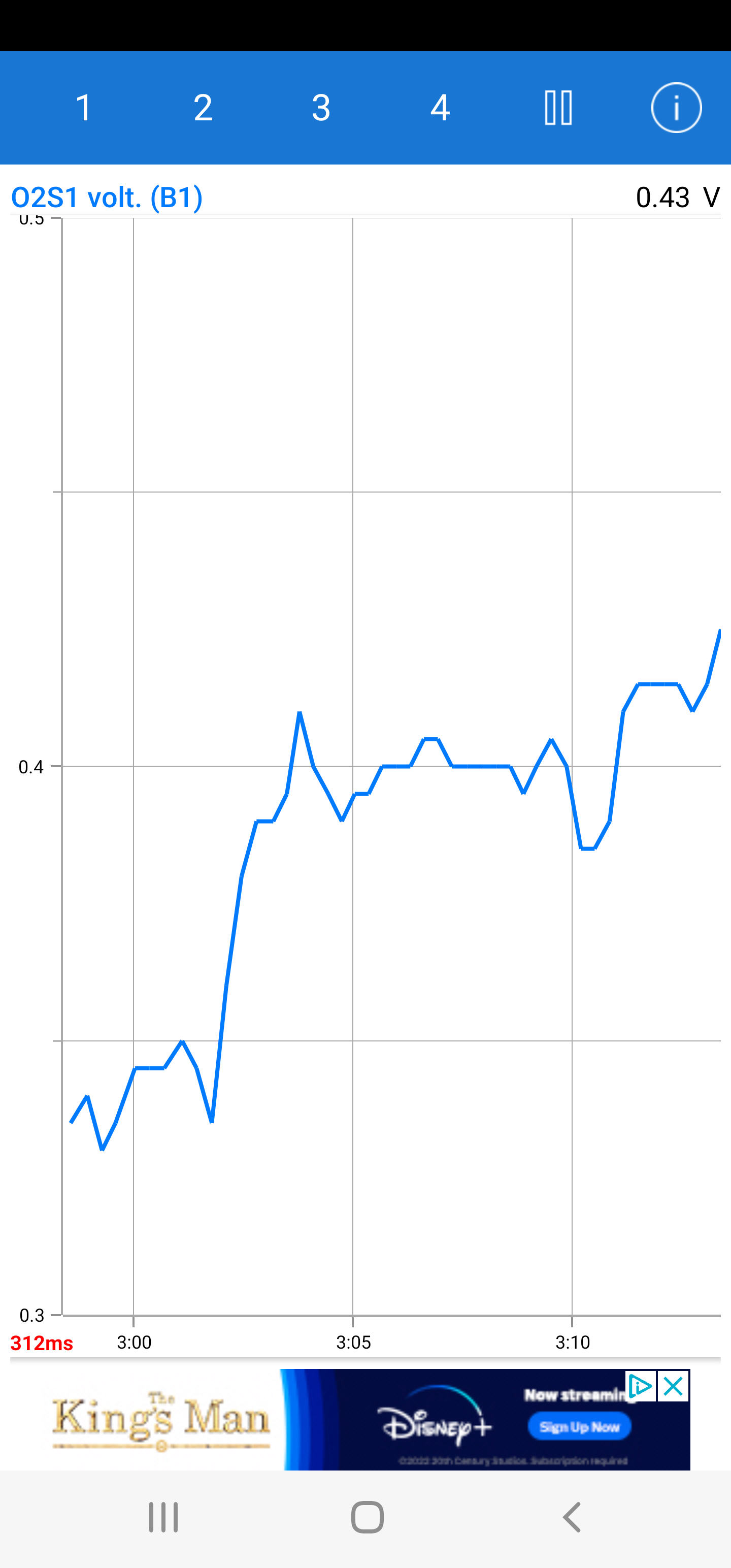

I will get my electrician on it. However, using OBD2, I found the following which I suspect is not normal:
0 voltage on startup for O2 Sensor 1 and over a period of 3 minutes, climbs only to 0.43V.
You’re right that doesn’t look at all right. Which OBD programme is that?

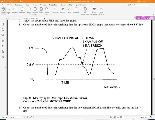

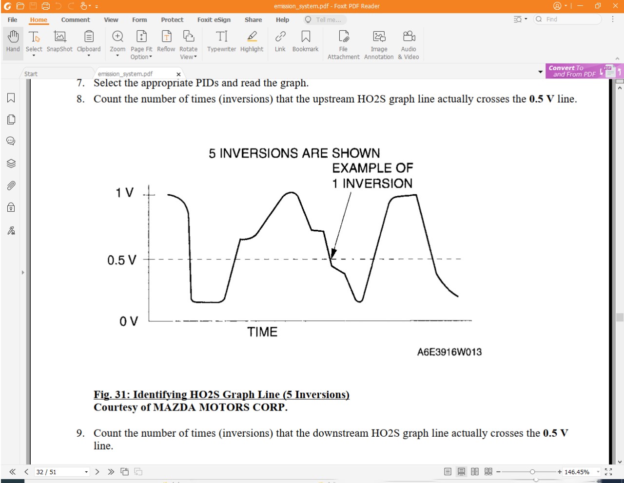

That seems to be in line with the information in the repair manual for both sensors
