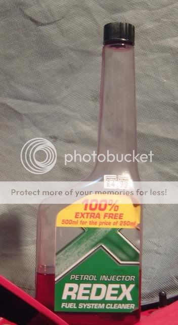

This is the stuff I use on every other tankful of petrol. My car has never failed since I started to use it. By the way does your engine run steady when idling?

I will definately try the redex tomorrow, not done this before, I assume it will give instructions on the bottle, probably just pour in the tank after fuel I assume.
I’ll let you know, as you say, worth the retest fee to find out before spending on the CAT.

One bottle is enough for 4 tanks full of petrol. Don’t be too impatient as it may take 4 tanks full to clean your engine injectors.
Cheers Pollyanna,
I best get some miles in then!!
