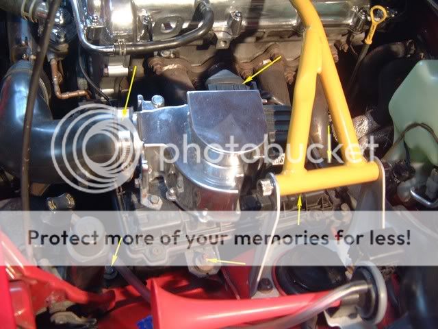

This is a picture of the strut bar that came with my imported Enos Roadster. They are made from very strong steel tube and they all appear to have been painted yellow. Thay have an adustable scew and nut in the top of the bar too. The second picture shows what it now looks like with the yellow paint removed, all welding smoothed up and the whole bar polished up.

 I won the strut bar that I was bidding for on ebay, its like the one Polyana has on the pictures above.
I have just fitted it but now my bonnet wont close, what have i done wrong? Should it just fit?
 Fit it the right way around.
Slacken off the adjuster, then fit.
Are the barackets that the strut fastens to the same as in this picture? (ignore the yellow arrows) And your car is the Mk1 is it not. Not sure if this is possible but, do you have the brackets fitted the correct way round?

I have just measured the distance between the top of the Cam Cover to the the underside of the strut and it measures 38mm.
If you have the standard air filter on as I do you can’t put the strut on the wrong way as it would catch the air filter body. But if it isn’t a standard filter it may be possible to fit it it the wrong way round and it may then catch the underside of the bonnet due to it sloping down wards.  If all else fails, post a picture/s so I can see it please.
 it looks the right way round i terms of it looks like the fiited picture above but my adjuster is at the opposite side to yours
 sorted, as you said, i had it on the wrong way round.
