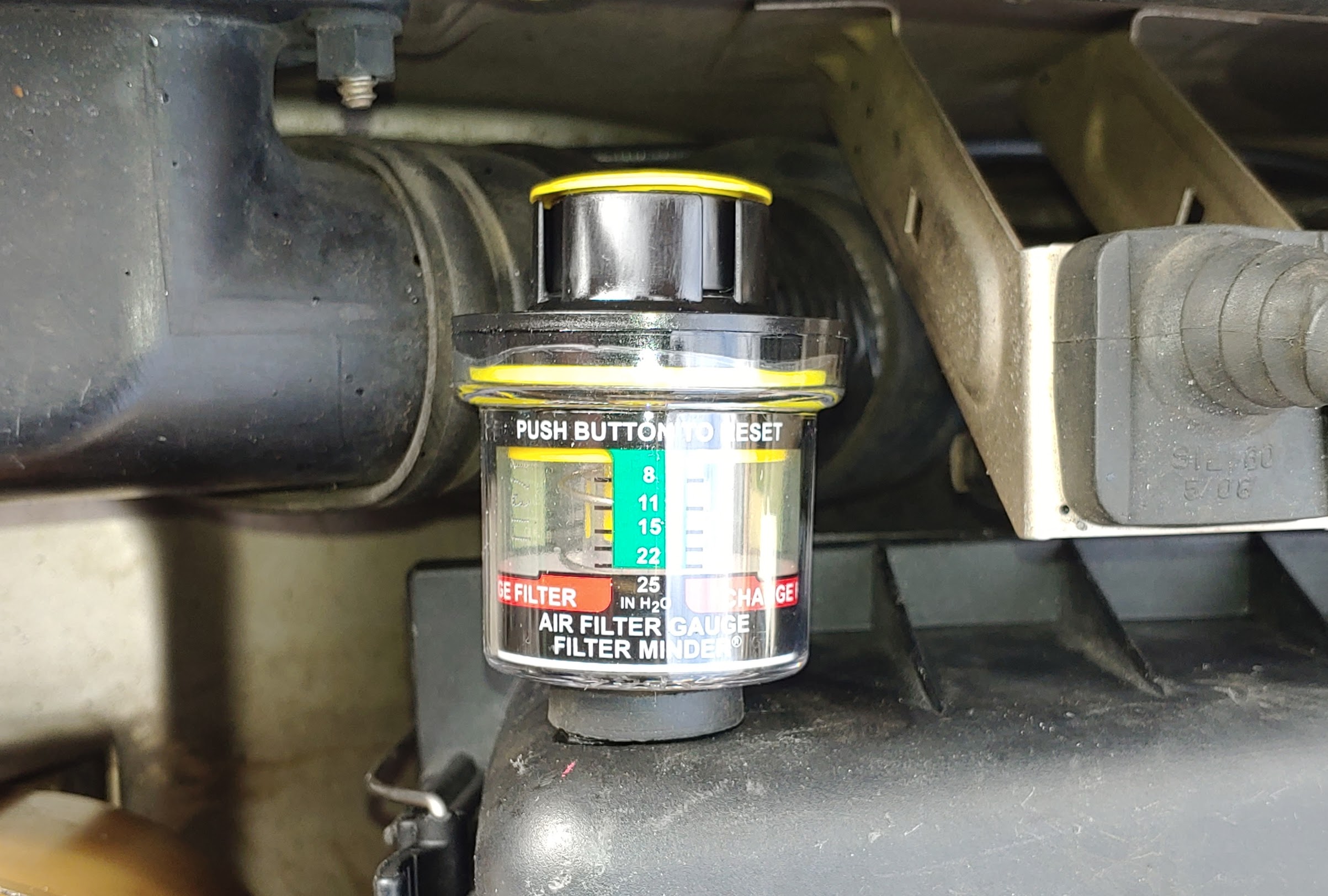

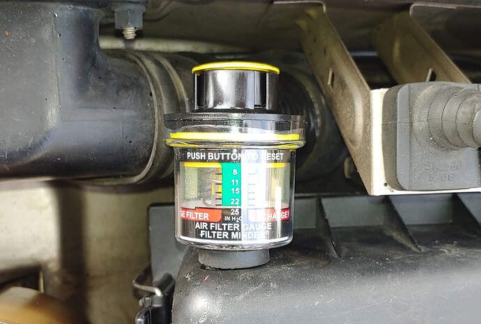

These sorts of devices are often found fitted on the big corporate fleets in the US, and I think at one time GM in the US was fitting similar devices to some vehicles/

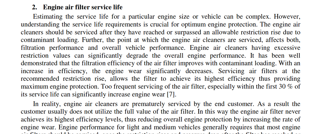

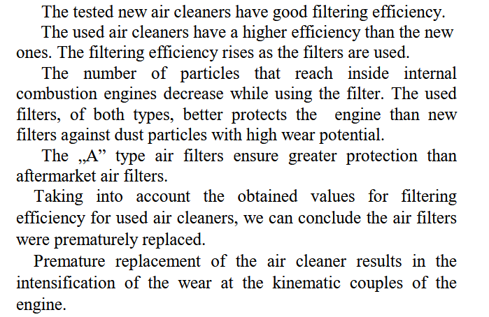

There are a few studies that show that not only blocked air filters will restrict performance, but that paper filters that are changed too frequently can actually contribute to engine wear, based on how filtering efficiency changes during service life.

When you same “little oil”, all that is needed, twice in the life of a vehicle, is a light misting, and let dry before fitting.
If you are driving the normal 10k per year, this frequency of air filter maintenance is, paradoxically, reducing engine service life.
An old air filter traps more particles than a new air filter. But ther is a trade off; as the filter ages, it clogs, leading to a fall in engine efficiency.
