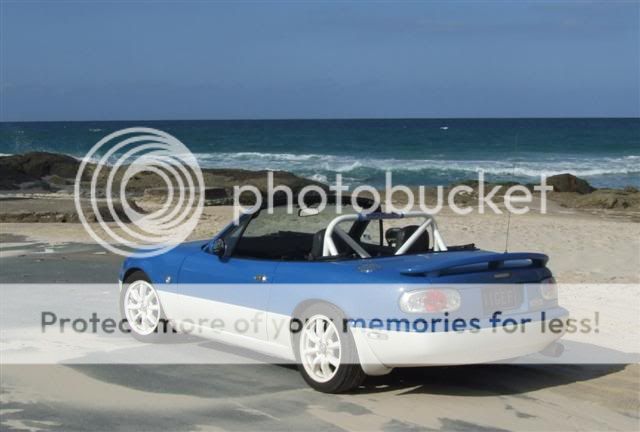

By the way, I like your thinking on the colour scheme, mines Chaste White under Mariner Blue
That sounds nice (the colour) - do you have any pictures?
And thanks for the advice - I will enquire with Autolink.
Oh yes, I’ve got hundreds…don’t panic here’s a taster from last years owners club calendar November—
