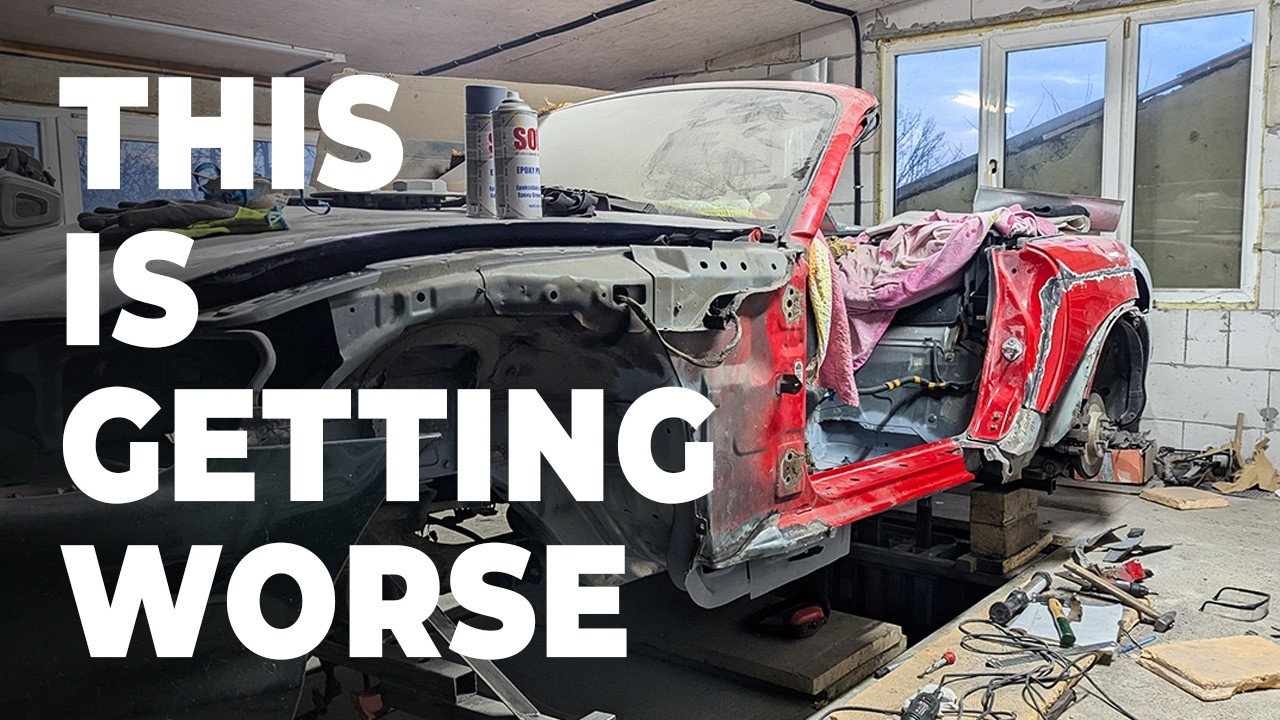

Not sure if you’ve resolved this yet, but I came across a picture of the nut from the inside in a video of someone working on a very rusty NB where they had cut away the rear bulkhead.
Visible for a few seconds from 8:05 (the rusty one, slightly right of the middle of the screen) :
(Remember, there’s always someone worse off! :grimacing: )
■■■. I used to have a pair of jeans like that back in the day. More patch than jeans !
No not sorted yet. I’m going to try to weld the nut through a drill hole or two. But will have to wait till I get her up on ramps and clear the area of waxoyl and get a new fire extinguisher !
