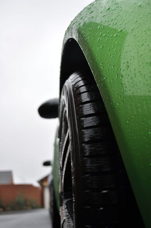

I bought and installed some third party wheels that were advertised as having the correct offset for the Mk3 MX-5. They are 16R-7j ET40 as opposed to the original 17R-7j ET55 Mazda wheels.
The first thing I noticed was how far they stick out compared to the originals (see picture). I’ve also observed a change in the cars handling. The steering feels a little more ‘darty’ wanting to turn in quickly, plus there is an increase in tramlining and the wheels wanting to follow bumps etc in the road.
Will these wheels cause any problems (such as premature wearing of bearings/suspension joints? etc)
Does anyone here run ET40 offset wheels with any problems? Did you notice any changes in handling/steering? I’m running the recommened Mazda tyre size of 205x50R16.
The supplier said they’ve sold plenty of sets without any issues.
I just want peace of mind that they won’t damage my P&J, and not knowing much about wheels I went with what they said were correct for the car.

It’s not so much the extra width (1/2 inch more than the Mazda standard 16"), but the different offset. ( the 7J +40mm wheels will be spaced out an extra 15mm + 1/4 inch (6.35mm), which gives an overall spacing of 21.35mm on each side).
It’s this extra 21mm spacing that I’m most concerend about. As above I’m concerned about over stressing the suspension joints/wheel bearings. The change in handling is also not welcomed. I did a test run today and the car starts to ‘wander’ slightly at high speeds (70mph+), so that can be added to the list of changes I’ve noticed in handling. It’s also worth noting I’m running Winter tyres on these wheels (I hope to have my original wheels back up and running by the summer, and thus use these as a spare or Winter set). So perhaps some of these handling traits are from the tyres rather than the wheels?
I also have two further smaller concerns about running this offset. As the wheels push out slightly past the wheel arches I believe they are technically illegal? I’ve also noticed I now spray up crap along the sides of the car, not so bothered about dirt but I don’t want to stone chip the hell out of the side panels!
The wheels were advertised as being 6.5J and having the correct offset for the MX-5. Both of which are incorrect. I expected them to list wheels that were the correct specification for the car, so I’m a little disapointed that they weren’t as advertised.
Anyway I’m told they’ve sold several sets without issue. So…
Does anyone here run ET40 offset wheels? and do any of the 4 issues I’ve outlined above cause any problems in the long term? I just want someone to say… yes I’ve run ET40 wheels for 20K miles and my suspension hasn’t fallen apart yet…etc :slight_smile:

Now that I’ve been running these wheels for a while I thought I would add some feedback.
I’ve since had the car precision aligned on a hunter wheel alignment machine. Some of the figures were a little off, and post alignment the high speed ‘wandering’ has pretty much gone. The heavier feel to the steering remains, but I’ve pretty much got used to it.
The biggest drawback to these wheels has turned out to be stone chips. Sticking out slightly from the arches means I’ve started getting stone chips along the side sills and lower doors. Maybe half a dozen or so on each side in a couple of months. Probably wouldn’t have been so bothered if it was an older car or a different paint scheme. Anyway something I didn’t consider.
I’ve since discovered that these wheels are also sold in an ET48 size, which would have been perfect and kept the tyres inside the arches. MX5parts in their infinte wisdom sell the ET40 version Thinking No idea why? So something to watch out for when buying third party wheels. I posted a similar thread on an American Miata forum. The feedback was that ET45 is about the limit before you start ‘coming out the fenders’, though some of them apply heavy camber and roll the wheel arches to fit even bigger and wider wheels.
