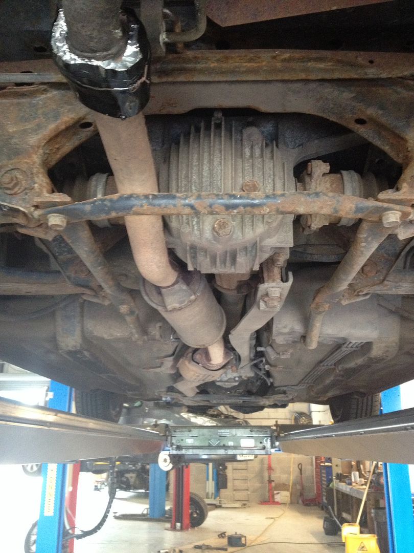

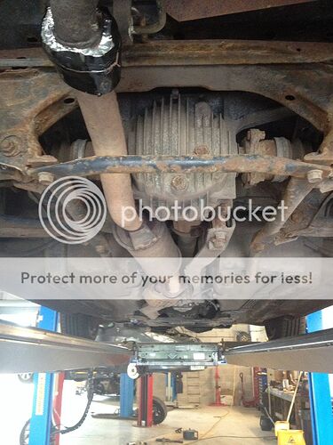

Ok so I may still have it? Do I need to pop the clutch on a wet road and see what happens? I’m still hoping my car has lsd but I’ve not had the opportunity to brake much traction yet
Possible to tell from this? 1993 eunos S special

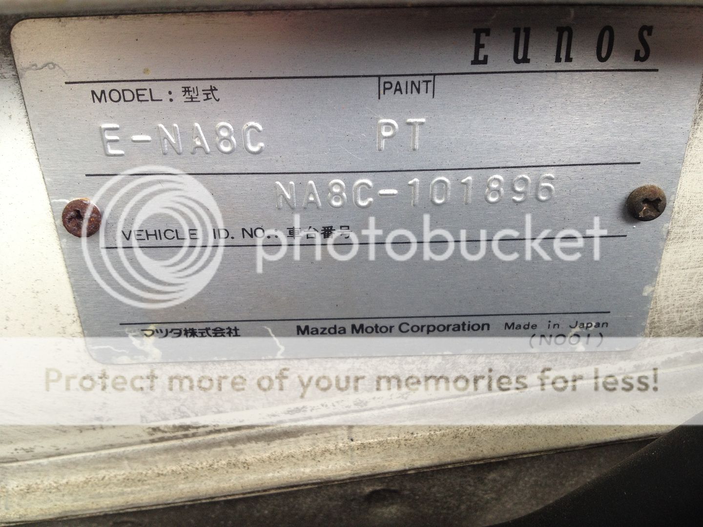

Since thats a 1993 1.8, and you have said its a S-Special, it should have come from the factory with a 4.100 Torsen T1. The door sticker will identify the grade.

I really struggle to burnout it just chirps and goes off down the road.
Unfortunately the door sticker is now just white with nothing on it.

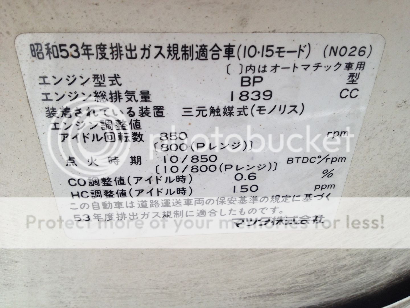

I found this under the bonnet?
The uncertainty is driving me insane.
If anyone is interested i called up Mazda UK with the VIN and 24 hours later the delightful young lady called me back to confirm S-Special status and Minty left the factory with a Torsen LSD. This backs up my less-than-scientific studies on the local industrial park so I’m sure it’s never been removed.
