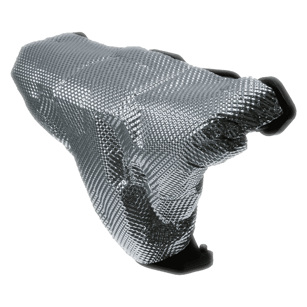

I ordered an IL Motorsport exhaust manifold for my 2.0 NC2 in the MX-5 Parts Easter sale, and I’m looking into the best options for keeping the under bonnet temperature down. I’ve narrowed it down to two options;
  1. Heatshield Header Armor manifold blanket
  1. Ceramic coating
Heatshield Products claim that the manifold blanket stops more than 60% of the heat from radiating into the engine bay, whereas ceramic coating could reduce the surface temperature of the exhaust by up to a third. I’m just a bit confused about which is the best option; any advice / opinions gratefully received!

I used a proper heat blanket from TDR on a previous car to separate the supercharger from the aftermarket manifold, it worked very well. Haven’t used ceramic coating but when I looked into it recently there were various options and even the most expensive claimed 30 or 40% reduction which is way less than the blanket did.
IMHO if you are going to turbo it or go racing / serious track use (and with serious I mean repetitive hard track driving / punishment) then yea look at these options. if you do not fit in these categories just use the OEM heatshield mate.
That’s what’s confusing me! If the purpose is just to keep the heat down, and protect other things in the engine bay, I think the heat blanket is probably the way forward. Lot cheaper too!
